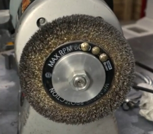

Homemade bench grinder hub constructed from 6061 aluminum. Intended to remove runout and vibration when using a wire wheel. Assembly was balanced using screws.
