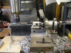

Homemade bending setup intended to enable use of a mill to produce repeatable bends in small diameter tubing. Tube bender is mounted in the mill's quill with horizontal infeed controlled by a boring head.
