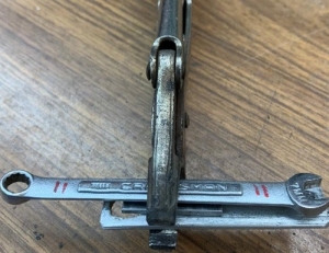

Homemade carriage bolt wrench constructed from bar and aluminum stock, a metric wrench, and a pair of locking pliers. Used to hold the carriage bolt so a nut can be used to clean the threads.
