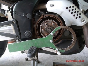

Homemade clutch hub holder constructed from 1/4" aluminum plate and a surplus clutch disc.
