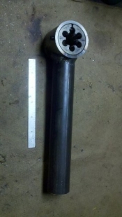

Homemade die holder comprised of 2-3/8" thick-wall pipe. Utilizes a pair of 5/16" set screws to secure the die. Handle is a length of 1-1/2" pipe.
