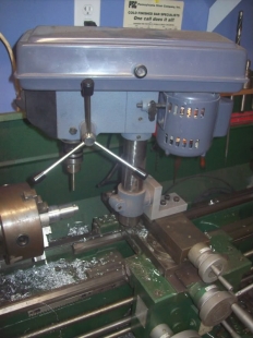

A homemade adaptor for mounting a drill press on a lathe. A T-slot is fixed underneath the angle plate. Knuckle is modified to accept 5/8-11 bolts.
