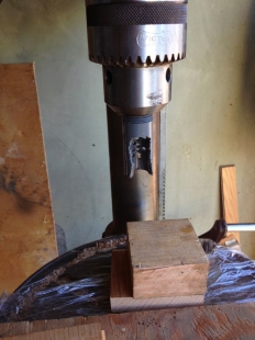

Homemade Drill Press Valve Spring Compressor
DustyRags on advrider.com
Homemade drill press valve spring compressor consisting of a short length of PVC pipe secured in the chuck. A third of the PVC pipe has been removed to facilitate access to the valve keepers. Wood blocks enable to correct positioning of the head.

With a large enough drill press, one could even do automotive cylinder heads with this trick. Good idea.
