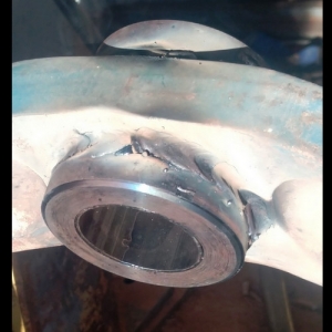

Homemade Ford tractor axle modification constructed by welding bosses to both sides of the axle. Prevents the center pivot from wearing out, which causes bent control arms.
