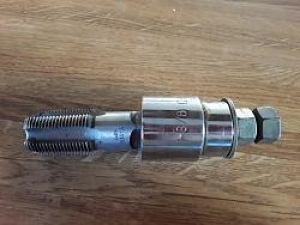

Homemade Injector Cup Removal Tool
Ro@drunner on homemadetools.net
Homemade injector cup removal tool constructed from a pipe tap, threaded rod, washer, nuts, and a socket. Allows removal of the injector cup without disassembling the head or rocker arms.
