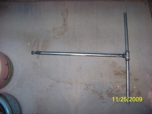

Homemade motorcycle fork wrench fashioned from lengths of galvanized pipe, a T-fitting, and a bolt with a hex head matching the fork stanchion's socket head bolt.
