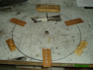

Homemade wheel lacing fixture intended to facilitate the process of centering a motorcycle rim and axle for the initial lacing steps. Consists of a scribed circle the diameter of the rim and wood blocks to secure the rim in place. A hole in the center serves to position the axle. Shims create any required offset.

Looks getto, but the way the user describes it, it undoubtedly works.
