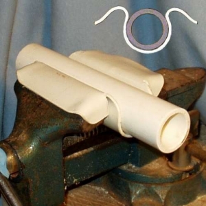

Homemade PVC Vise Adaptor
Thinkenstein on instructables.com
Homemade adaptor allowing PVC pipe to be more securely clamped in a vise. Fabricated from PVC pipe, which is cut, heated, and formed in place to the vise.
