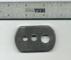

Homemade Rear Bearing Puller
Midnight Rider on chevytalk.org
Homemade rear bearing puller comprised of a steel plate with three holes drilled through it. The center hole facilitates attachment to a slide hammer. Intended for 1967-1970 full-size Chevys.
