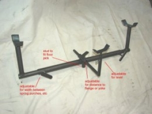

Homemade floor jack adaptor cradle designed to facilitate the installation of a rearend. Fabricated from schedule 40 pipe. Cradle is adjustable side-to-side to allow for different spring saddles, and includes an adjustable arm that supports the nose.
