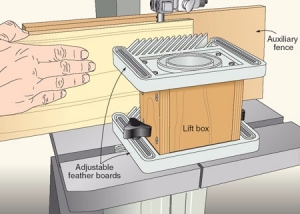

Homemade Resaw Featherboard
Joel Nowland on woodmagazine.com
Homemade resaw featherboard intended to apply pressure across a wide area. Comprised of commercial featherboards separated by a plywood lift box.
