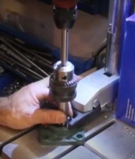

Homemade roller support for polishing steel rods. Constructed by press fitting a surplus drill chuck into a bearing. Intended for utilization with drills and drill presses.
