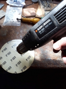

Homemade sanding disc adhesive restoration constructed by heating up the dried up glue on the pad with a heat gun. The same technique can be used to remove sanding discs.
