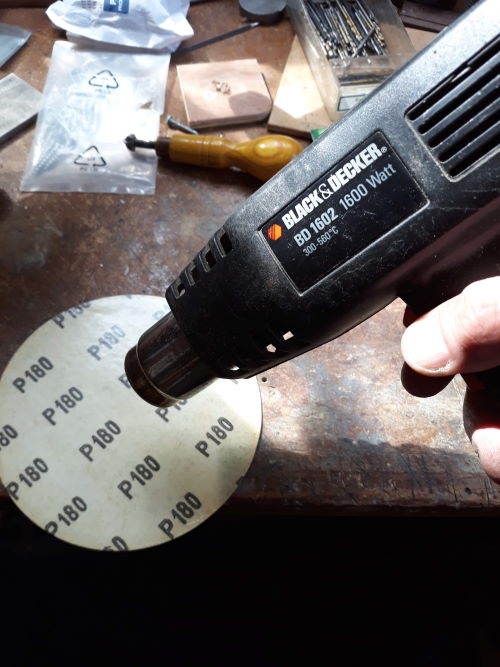

    Hi, had some old adhesive sanding discs that were nolonger sticky and came up with a way of refreshing them:
    Be very careful as hot glue can really burn.

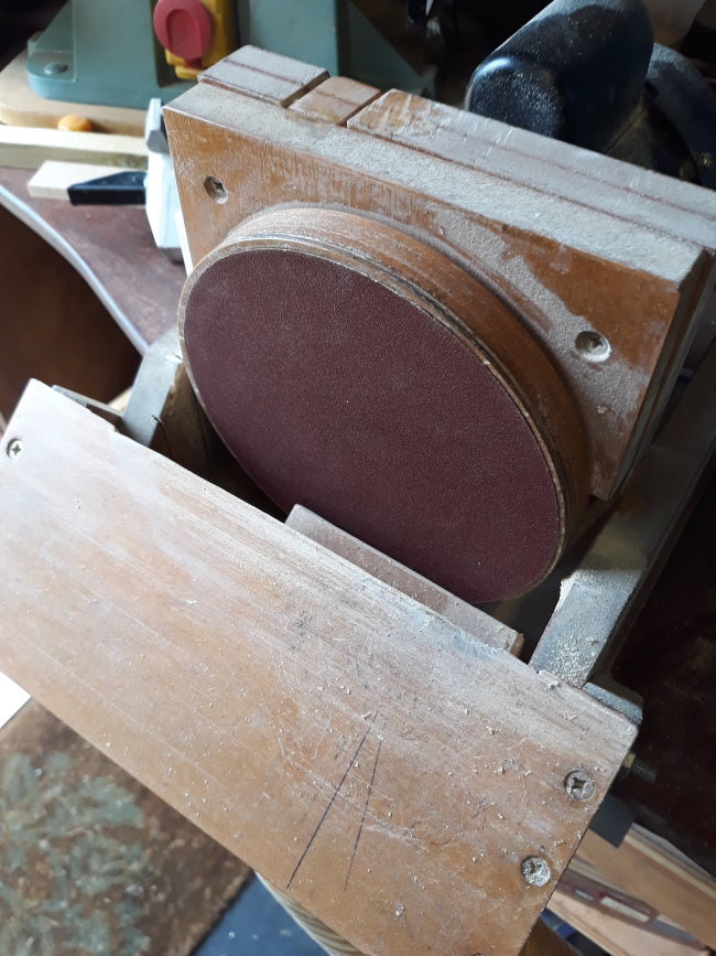

    They stick to the sander really well
