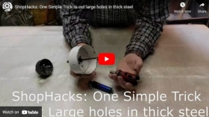

Homemade steel plate hole cutting method constructed by using a hole saw to delineate the perimeter of the cut and then using a drill bit to make a clearance hole for the swarf to go into. Used in the absence of an annular cutter.

Thanks, I have to cut 2 1.5" holes in 1" metal plate, now have idea how to with tools on hande.
