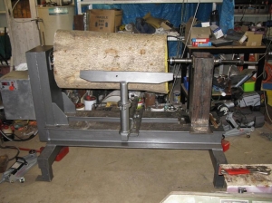

Homemade wood lathe fabricated from steel and powered by a 4hp motor. Pulley-driven via a 4kW variable speed drive, the lathe is optimized for high torque at slow shaft speeds. Features a temperature-controlled electronic fan.

Ed,great job on wood lathe,4 KW ,variable speed ,just the ticket for lower rpm turning!Wildon
