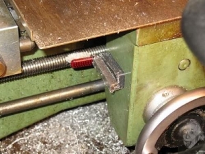

Homemade lead screw cleaner adapted from a toothbrush. Secured to the carriage with a magnet.

Hi marv,, I done something very similar but at the left hand end of the leadscrew to stop swarf migrating into the electrics and controls box on my old mini lathe,,,
I think it was the end of a suede shoe brush I used instead of a toothbrush.. (not the brass wire type)...
...Mike..
