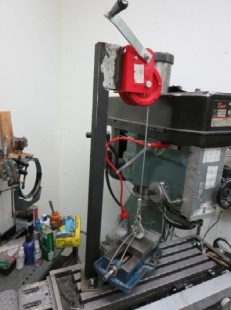

Homemade mill table crane fashioned from 1/4" steel plate, a length of steel pipe, square steel tubing, and a manually-actuated winch. Crane is attached to the table via standard studs and T-nuts.
