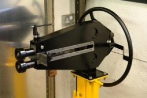

Homemade bead roller featuring a main body constructed from 10mm laser cut plates. The only proprietary parts used were phosphor bronze bearings and two reverse gears sourced from a Toyota Celica transmission.
