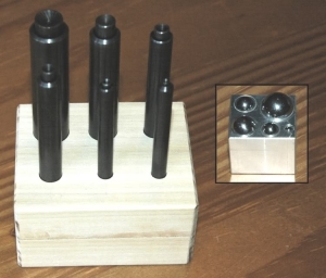

Homemade spring ball tools designed to be used in an arbor press. Tool consists of two pieces bound together by Loctite. Working edge is hardened. Base made from scrap poplar. Set includes 1/2", 3/8", 5/16", 1/4", 3/16", and 1/8" ball sizes.
