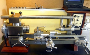

Homemade Stepperhead universal machine tool. Utilizes TurboCNC v 4.01 and powered by a 430-Watt, 1400 rpm, 240v AC three-phase stepper motor. Spindle speed is 15-3000 rpm, forward and reverse. Nema size 23 motors for the head, cross slide, and saddle. Milling head motor is 430 watts, 24v DC, with a speed range of 1000-4000 rpm. Overall dimensions: 1000 mm long x 600 mm wide x 500 mm high.
