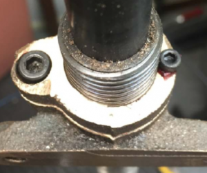

Homemade X-Axis Take Up Nut Improvement
rgsparber on homemadetools.net
Homemade RF-30 mill/drill X-axis take up nut modification made by sawing off the segment that bends, and reattaching it with a second screw.
