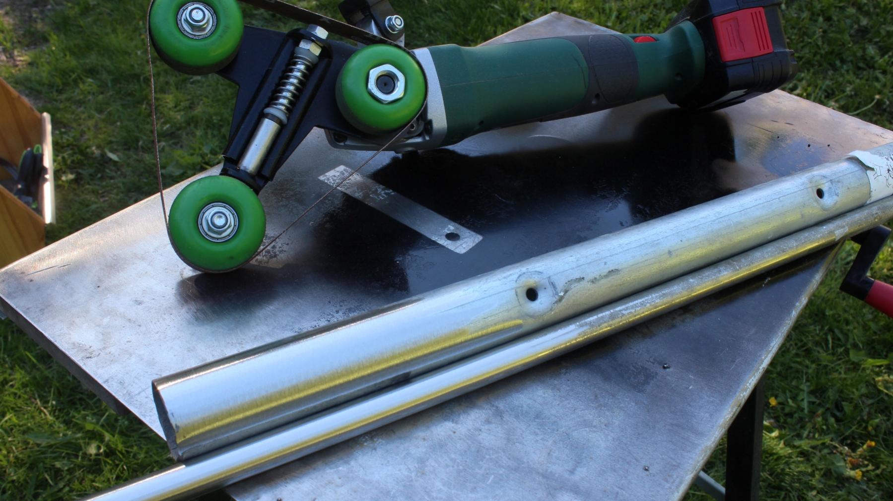

Made an attachment to my angle grinder.
Its for sanding pipes and curved edges. For smoothening welds, rust & paint removing...
Wanted to keep it simple as possible.
Later im going to update it with dust guard and removable backing plate, for using it like regular belt sander.

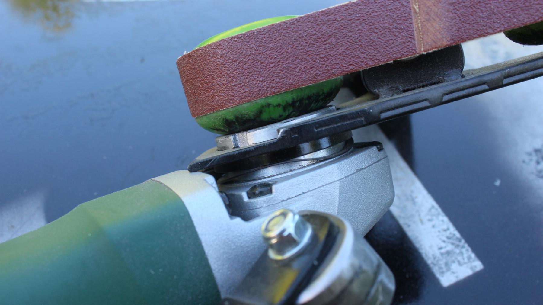

Attachment 23962
Ring under the "locking plate" leans to the spring washer.
Body is made from two 3mm thick plates.
This gives more strenght, but also adjust wheels to the same level.

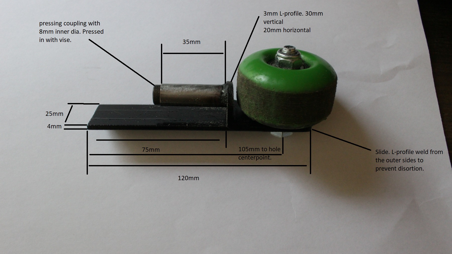

Attachment 23955

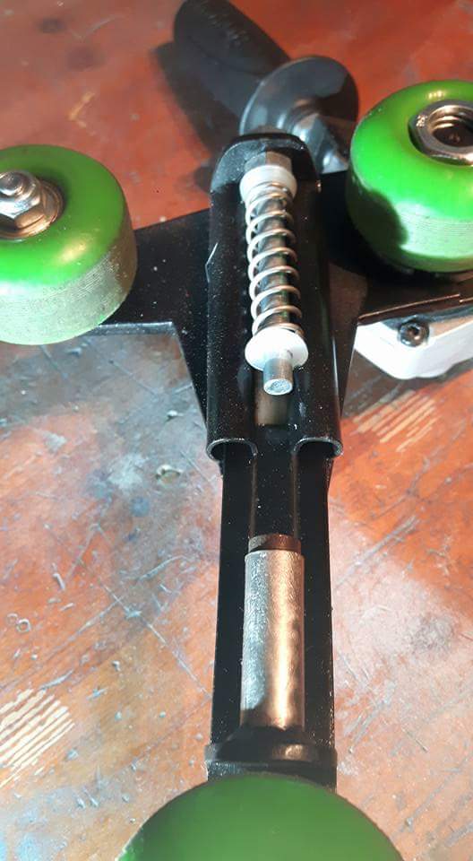

Slide to the tension system, is made from 2mm sheet and 4mm plate. Shape of the casing (2mm) gives support to the actual slide (4mm) from all sides.
Attachment 23963
Can be used with 20 and 40mm wide belts.
Belts are bought, wheels (52mm with 16mm hole, M16 nut locks the drive wheel ) from the skateboard.
Video shows the making and use.
https://youtu.be/mf6jLBvXkIA
Can be mounted/ unmounted within 10 seconds.

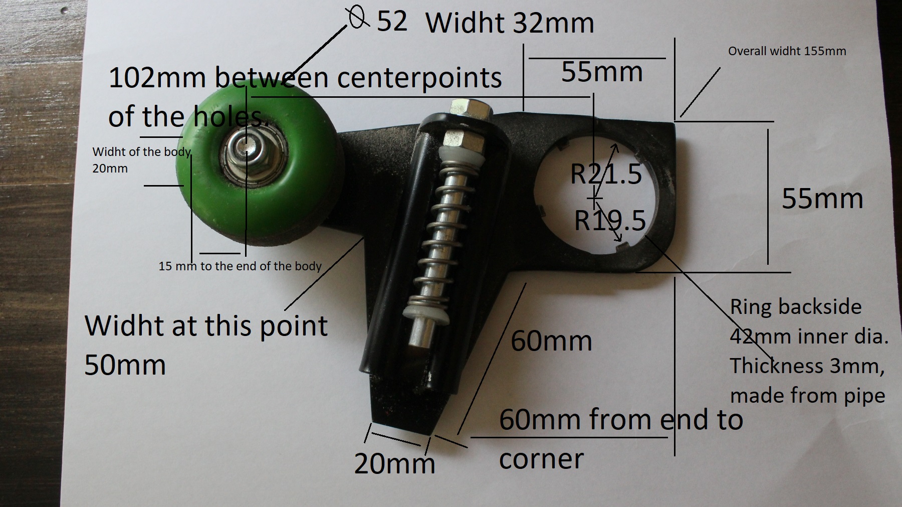

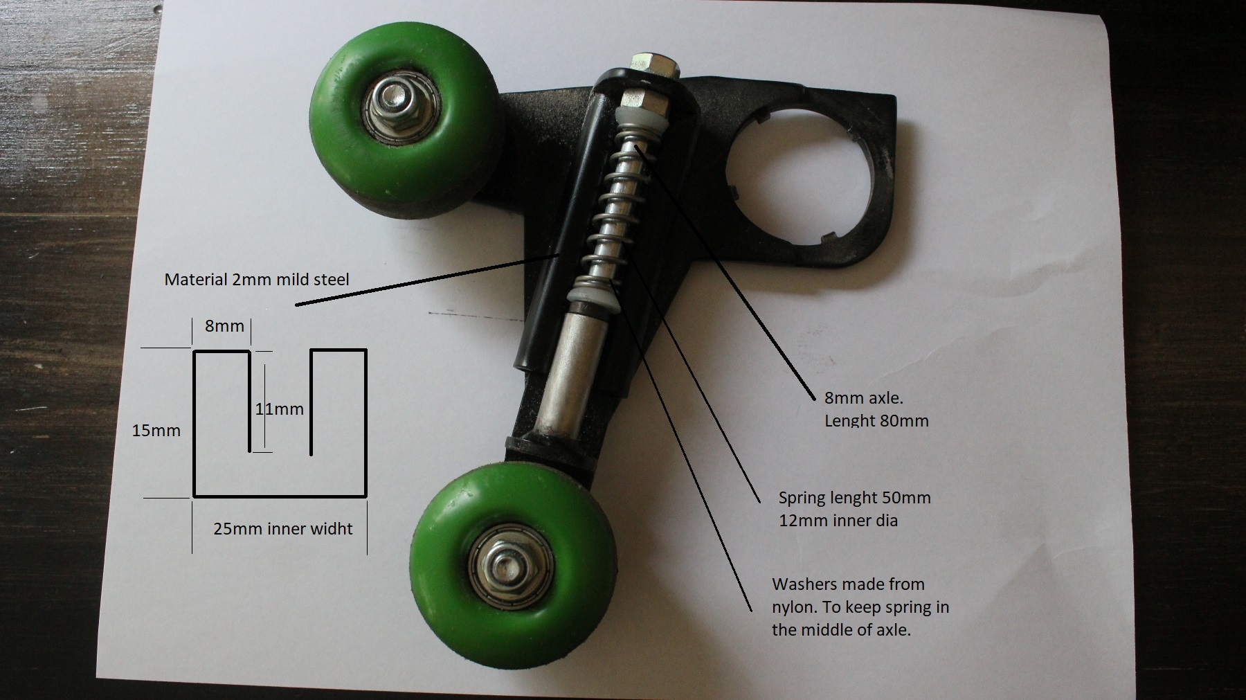

Here's simplified plans from it.
I designed this to be used with 520mm and 533mm long belts
Those are 1-2 euros each, so i didn't found reason to make my own.
White washers are made from nylon, and shaped to cone.
Reason for those is to keep spring centered, this allows it to move without touching the sides.
This gives better operation to it.
Parts of the slide are sprayed with silicone spray for better slide.
8mm axle has 20mm long M8 thread at the end.
Thickness of the disc guards locking fingers was 3mm, so i made locking plate from 3mm plate.
Because i had no big enough hole saw ( 42 mm needed ), i marked the needed diameter with compass.
And made biggest hole that i could to remove most of the material ( i had 32mm ), and used rotary tool and tungsten carbide cutter to remove rest. I finished the shape with hand files. This was actually somewhat simple task, and took only an hour to finish.
Mounting "fingers" wasn't located symmetrically, so i used fit, mark and file more method, instead trying to accurately measure or mark the locations.
