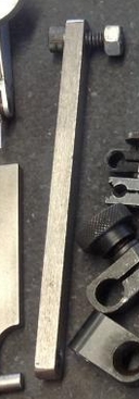

    I glanced your original post Tony and was struck with how simple but perfect a solution. I was in a hurry at the time but it hung around in the back of my mind. I thought it was because no matter what I'm trying to mount on my old height gage I can't seem to find the setup for a lugged DI.
    Then today I was doing some measuring and bang, there it was.
    A year or two ago I decided to go on an eBay hunt for a height gage. I noticed nobody was hot for the old vernier's so I started watching close. Finally an old well cared for Starrett 14" came up with a veritable slew of attachments plus an old B&S .0005 DI w/buy it now of $110! I thought surely in all that I could mount ANYTHING, wrong. I still couldn't seem to work the lugged DI, until today. Now all the sudden that long piece close to the middle made sense finally. Makes me crazy I'd shifted that thing out of the way several times trying to solve that puzzle.
    Thanks for lighting this dim bulb.Digital or dial indicator on height gauge-image.jpg

    C-Bag, is this the attachment your referencing?

    Yup, that's the one, sorry, I don't have an editing prog.

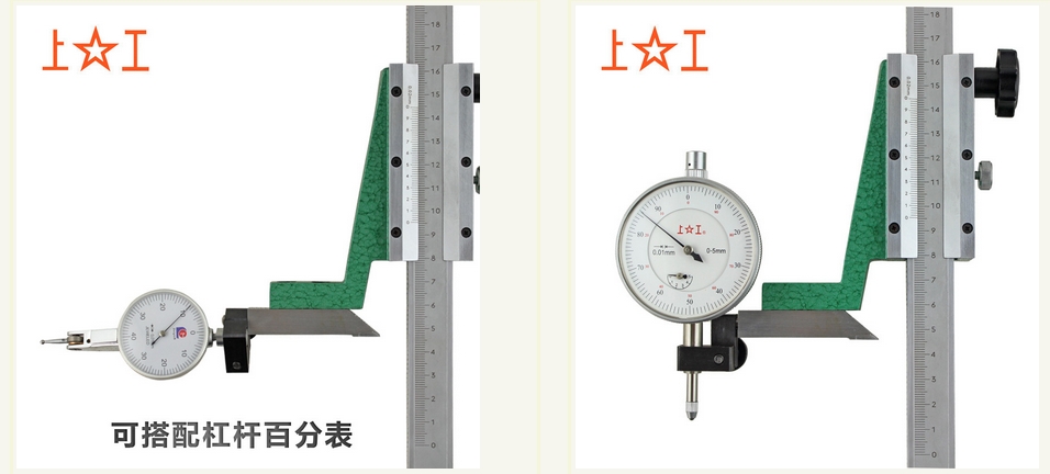

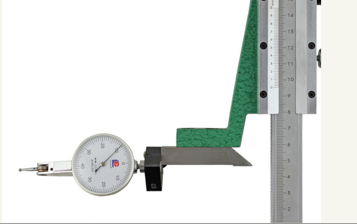

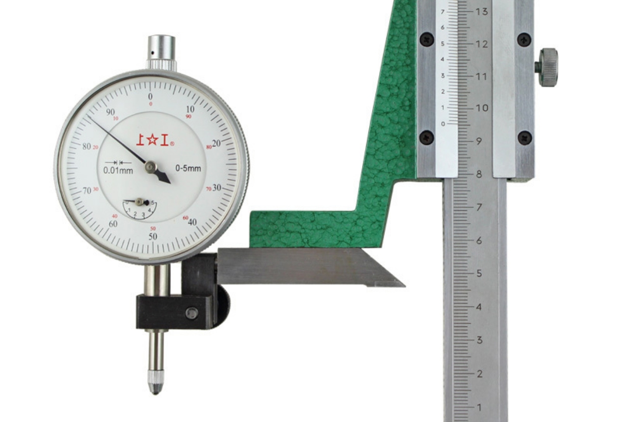

    Random search found these
    So I was searching for surface gauge info, and found this photo of a height gauge attachment;
    I could not find any reference to this other then the photo credit of Aliexpress.com, and I could not find any industrial tools there.
    Digital or dial indicator on height gauge-di-height-gage-mount.jpgDigital or dial indicator on height gauge-dti-height-gage-mount.jpg
    Seems simple enough to copy. A side view would be handy.

    At first glance, maybe. But look close at your DI's. Grabbing it where the plunger is, is not that great an idea and the cap on the other side. What do you do with that? Personally the attachment Tony showed and obviously the guy who had my old height gage knew what was up an is truly simple, IF you have those kinds of clamps that go over the probe and the attachment, which luckily came with my gage. It can also be rotated 90deg so far it's been just what I needed. It just kills me it was under my nose all along. For me it's been hard to find how some of these attachments work as they aren't as self evident as I thought. So far I've not found a comprehensive demo of how they are all used.

    Looking at the photos of these height gauge dial and test indicator adapters, I'm of the belief these are concept drawings, and you can't buy them, as there really is no value in the setup reusing the carbide scribe. And the short cantilever limits surface plate uses.
    I don't have issue with clamping to the stem of a dial indicator, it's a finger tight thumb screw, not some bolt that is torqued and distorts the stem crushing it into an interference fit with the spindle of the indicator. I've not seen the need to tighten the thumb screw to cause bite marks in the stem. I do see the value in using the lug as intended, as every dial indicator I have, came with a lug back.
    I have more issues with snugs that adapt the mag base or surface gauge to the indicator, as they all want to clamp round rod to round rod. The mag bases all came with a thumb screw tightened adapter, that attaches to the indicator lug (which fits DIN or AGD lugs), and then the snug clamps onto this.
    Try to find adapters from metric DIN indicators to inch AGD bases. And from AGD to the import mag base which are metric. I've not found a snug that's intended to interface between them.
