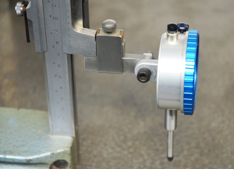

    metric_taper started a thread http://www.homemadetools.net/forum/s...-holding-60204 over on "Tools in progress" to which I added some pix. DIYer asked if I was going to make a separate post. I wasn't planning it but then I had a job for it this afternoon and made a video whilst measuring.
    So for completeness here are the original photos and the video.

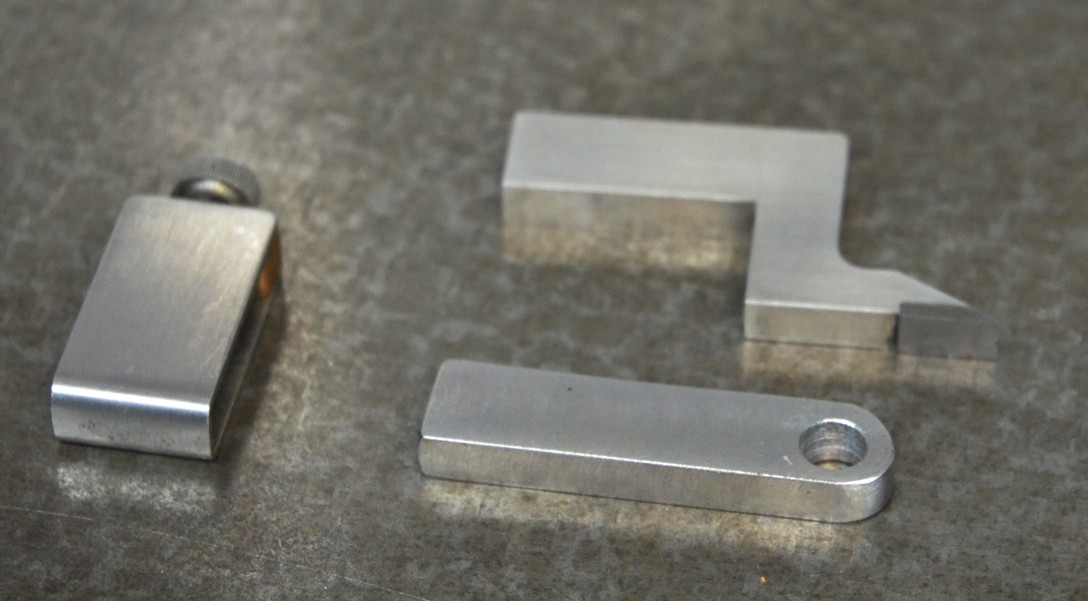

    This shows a simple rectangular piece to bolt to the lug on the back of the digital/dial gauge. This get clamped in place of the scriber piece of a vernier height gauge.

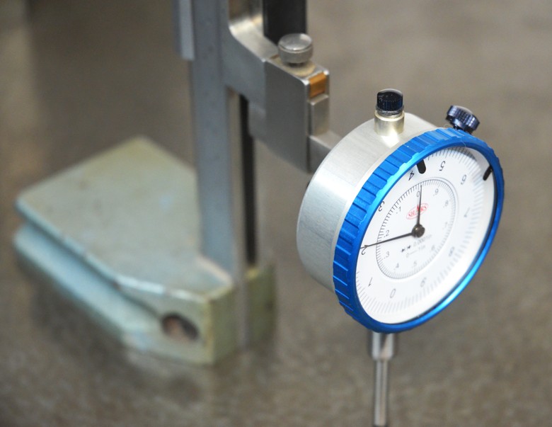

    Digital or dial indicator on height gauge-gauge-height-02.jpg Digital or dial indicator on height gauge-gauge-height-03.jpg
    A dial gauge fitted ready for use.

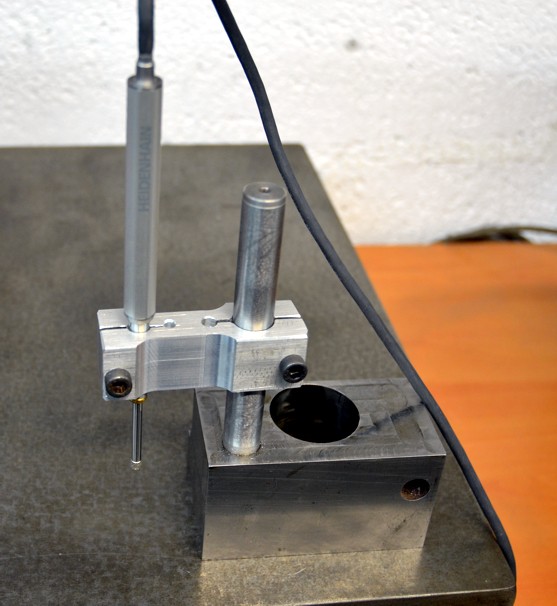

    Here is another way to hold an indicator, useful when there is no lug as with this linear encoder.
