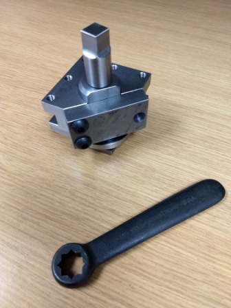

    Paul,
    Thank you for sharing your design. I recently completed building mine and all worked out well. I changed the post nut to be able to use an old wrench that came with my SB lathe. Otherwise it was made per the plans which were very clear and easily understood. Below is an image of the finished product less the handle which is currently on order.
