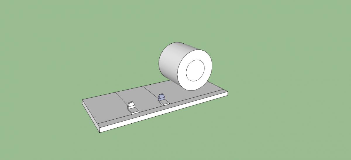

In the rubber will be installed metal elements, so do not slipping during rotation.
Attachment 11414

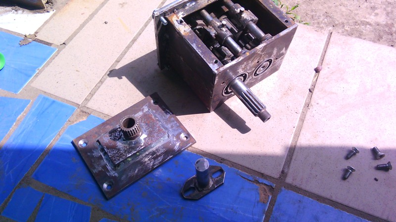

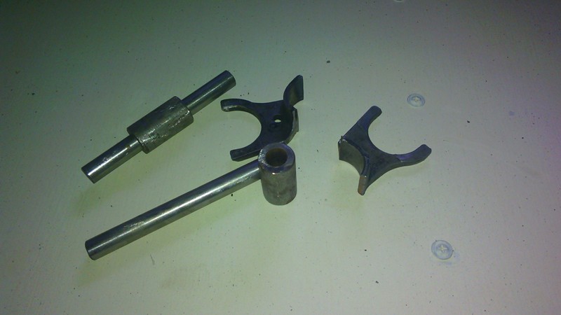

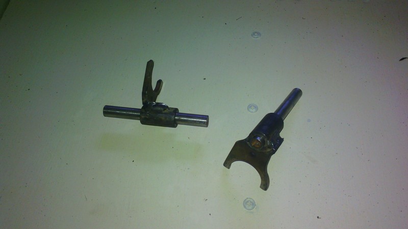

Made Fork mechanism for shifting gears.
Attachment 11457 Attachment 11458
Tomorrow I plan to make the locking enabled speed. Gearbox mini dumper will have 2 speeds.
Attachment 11459

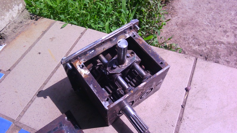

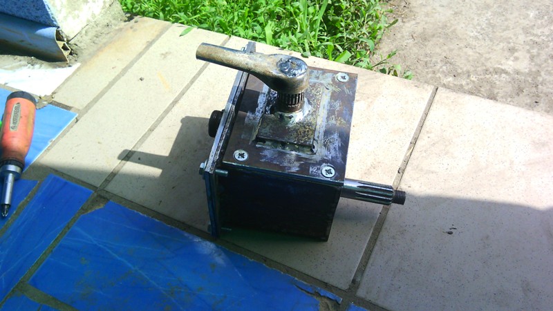

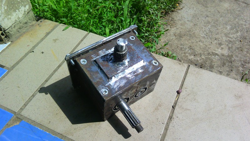

Finished the gearbox.
Attachment 12265

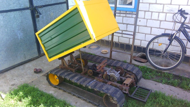

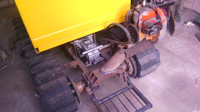

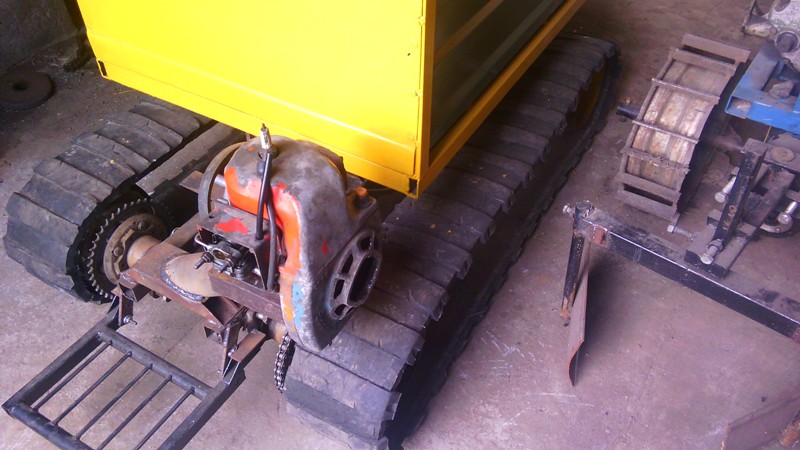

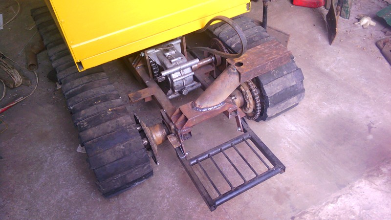

Made attachment to the engine. Gasoline 2 stroke engine, 100 cubic centimeters, 5 horsepower. This engine 1984, I set a new piston and cylinder, and later set a petal valve and a modern carburetor. I know it's not a good solution, but I do not have another engine.
Attachment 12696 Attachment 12697 Attachment 12698

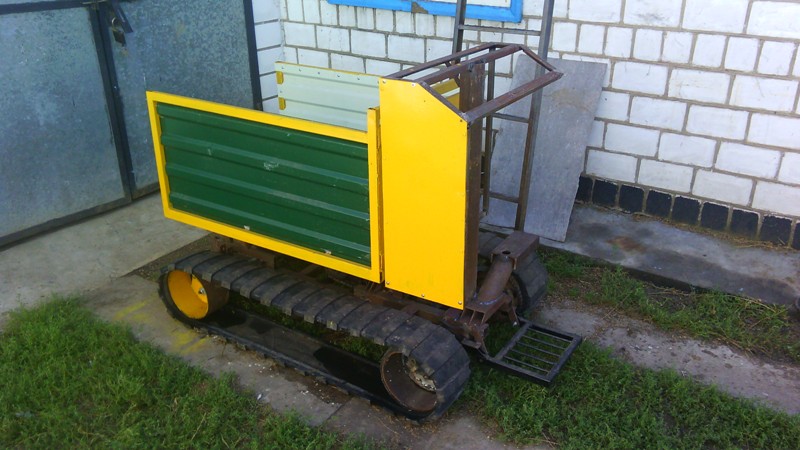

I started doing paneling
Attachment 13400
