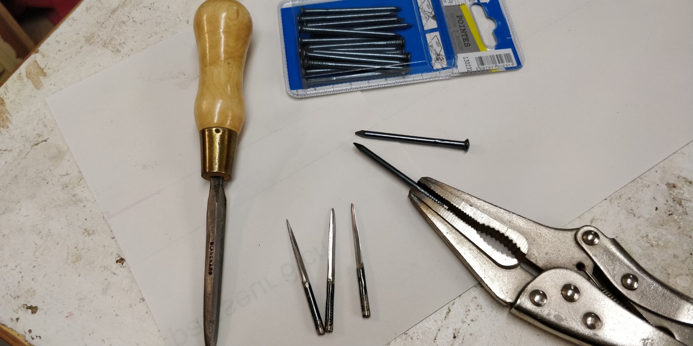

    Here is how the blades are made, starting from a hardened concrete nail :

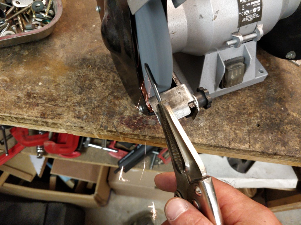

    First, roughing out with a high speed grinder (I frequently dip the blade in a jar of water before it looses its temper).
    I grind four faces, in a kind of sword shape.
    I made a small batch blades of different width

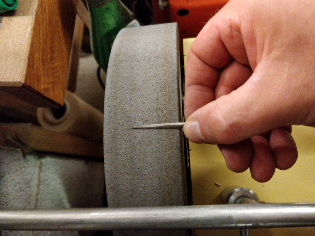

    Then I switch to the wet slow speed grinder, and I refine the edges. The tip is quite flat and cutting, and the body has a diamond shape, more intended to expand the hole than to cut it.

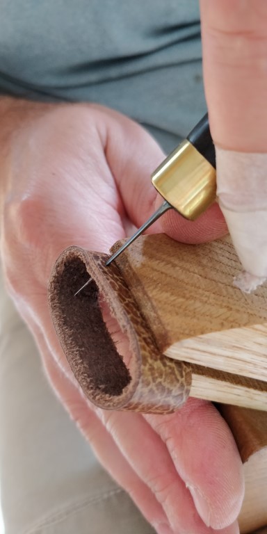

    And here is how it is used, with the stitching clamp I will show next time.
