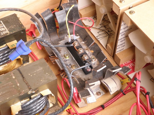

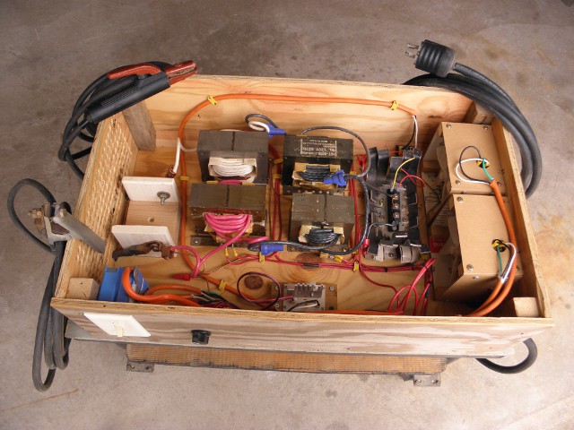

Home made Microwave Oven Transformer (MOT) stick welder. I based my design on the welder by Daniel B. Hartman (Dan's Workshop). This welder is made from four transformers from old microwave ovens. The transformer secondary coils were rewound, to achieve welding voltage, with 6 AWG solid copper wire. I included two fans from one of the microwaves for cooling. The power adjustable so it can be used with various sized of welding rod. The SCR module used to adjust the power is mounded to a homemade heat sink made from two old aluminum frying pans.
Input: 240V, ~25 Amp
Open circuit voltage: 47 Volts
Welding current: 170 Amps
Rewound transformer secondary coils with 6 AWG stranded copper wire.
Variable power provided via SCR module

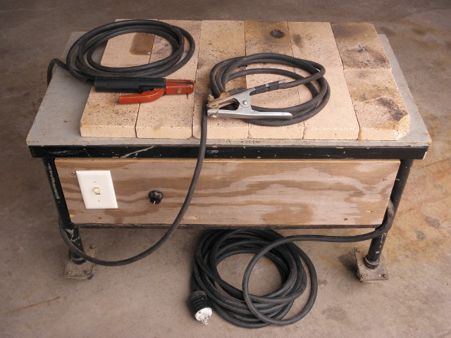

Welder installed on the shelf of a cart that I use for welding.
Attachment 3805
Welder removed from the cart with the top cover removed.
Attachment 3806
The SCR for the power control mounted to a homemade heat sink made from two aluminum frying pans.
Attachment 3804

Nice configuration! I've been wondering if more transformers would result in a better device. Seems like you nailed it.

Awesome work. The wooden box on a welder is no bueno. 1/8" aluminum is nice to work with if your experience and tooling is working with wood. You can even cut it with a circular saw. And the aluminum will help dissipate a lot of heat.
