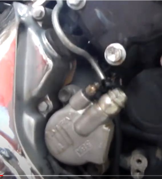

What about the master cylinder?
I have not seen a slave cylinder like the one that you have. 12/14 mm bore does seem small if it was direct acting but it looks like it retains the original Yamaha actuating scroll. I was expecting something like this
Attachment 42103
That is why in a previous message I expressed an interest in how you would mount it.
I doubt I'll be using this slave cylinder, it's just something to experiment with.

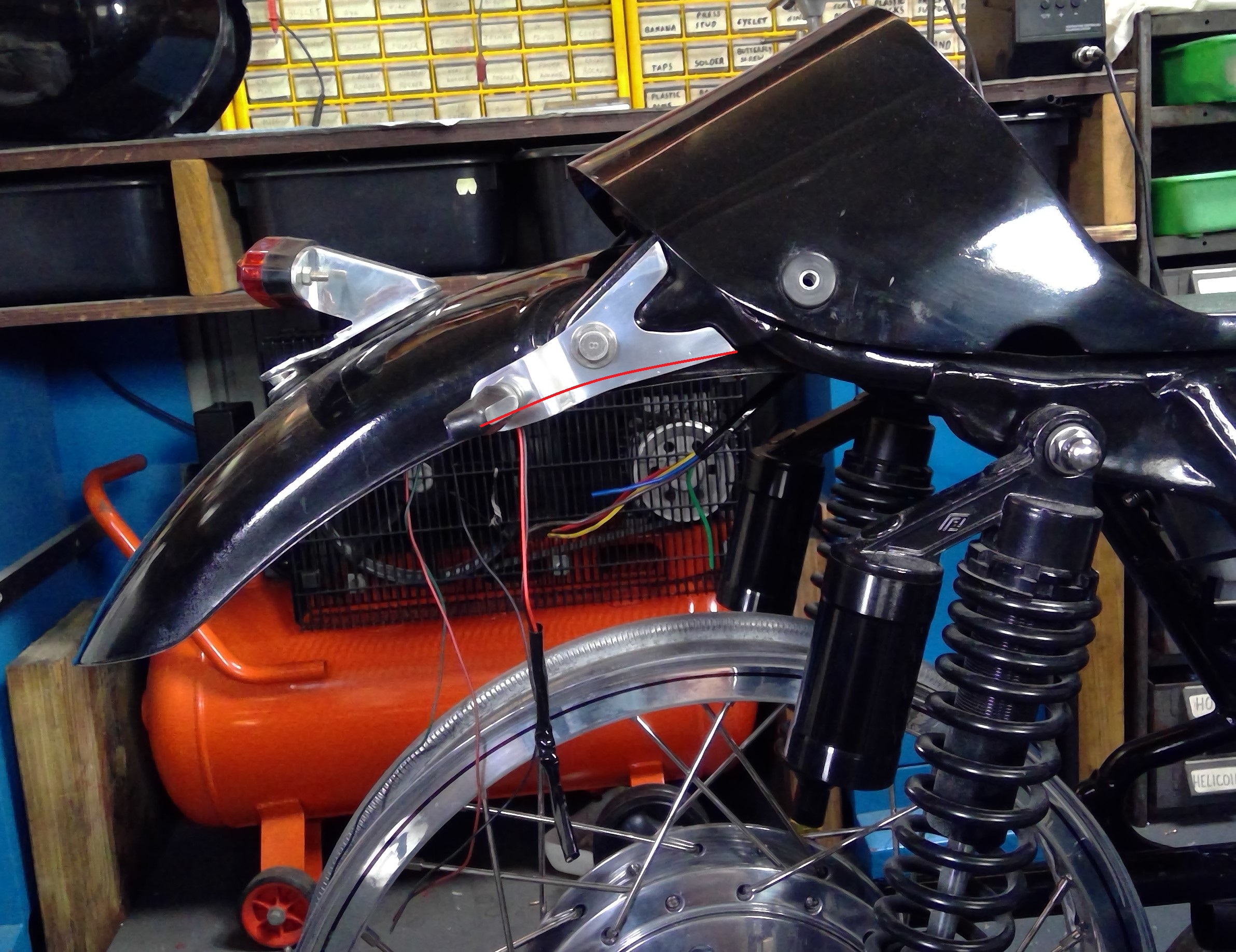

The indicators I bought don't have a long enough threaded section to go through the guard bracket, so I made these extension brackets to mount the indicators on. The V shaped cut out at the rear of the brackets fits around the frame tab protrusion, thus stopping the brackets from moving.
1 Attachment(s)
Nup, binned them. Looking at the picture I noticed the line on the top the aluminium bracket doesn't follow the line on the top of the frame tab. So I made a new pair. Not a lot I could do with the bottom line as the tab angle is different to the guard angle, so I followed the tab angle down to the bottom of the guard then followed the arch of the guard. I might have to thin it down a bit though, looks a bit too big???
The thinner bottom part of the first bracket look better. The pointed end of the upper part looks akward. Perhaps a rounded end ?
1 Attachment(s)
What if you added a radius to the bottom edge of the bracket similar to the radius of the fender lip. Not that anyone would notice it unless they looked directly at it from the side, but it keeps the lines smooth and consistent.
Attachment 42326
Nope, if I did that then the lower fork would be horrendously thick. That's why I followed the line on the bottom of the tab down to the guard then followed the line of the guard.
