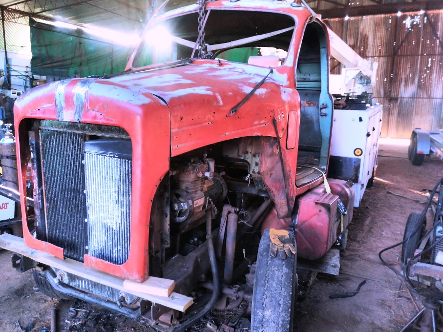

    After removing the old engine support crossmember adding two crossmembers in front 1 for the engine 1 for the core support I boxed the frame on both sides in this area from the crossmembers to the rear motor mounts
    looks like a good place to mount the steering gear. 20degree less angle and an inch further out in the frame
    The front cam mount in place which also serves as a crossmember for the rear motor mounts. Checking hood for slope and fitting to the radiator shell something's not right just yet.

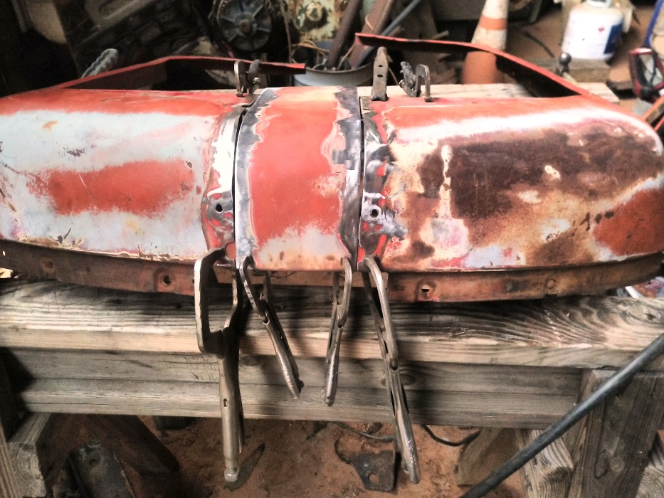

    widening out the shell

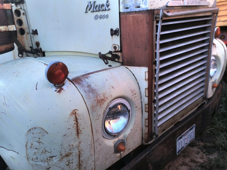

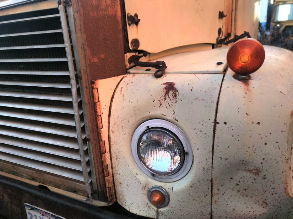

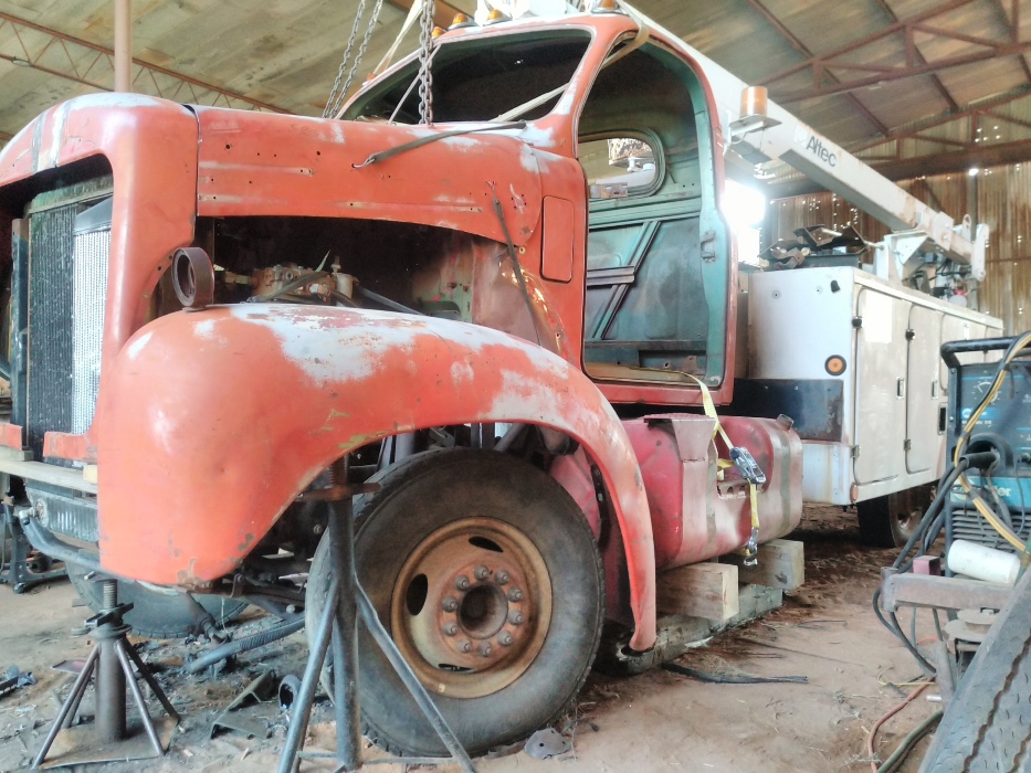

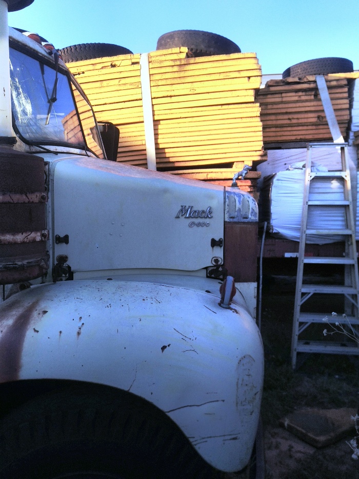

    I have a C model Mack that closely resembles what I am doing to the Frankin Built. but with a slightly longer hood and wider radiator shell

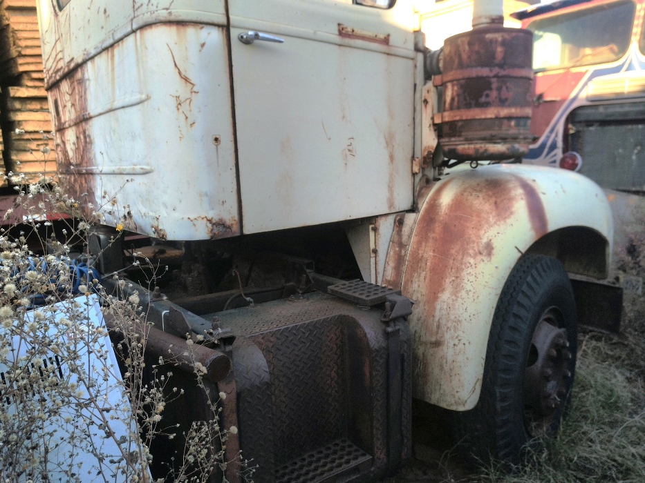

    Bat wing fenders, Interesting???

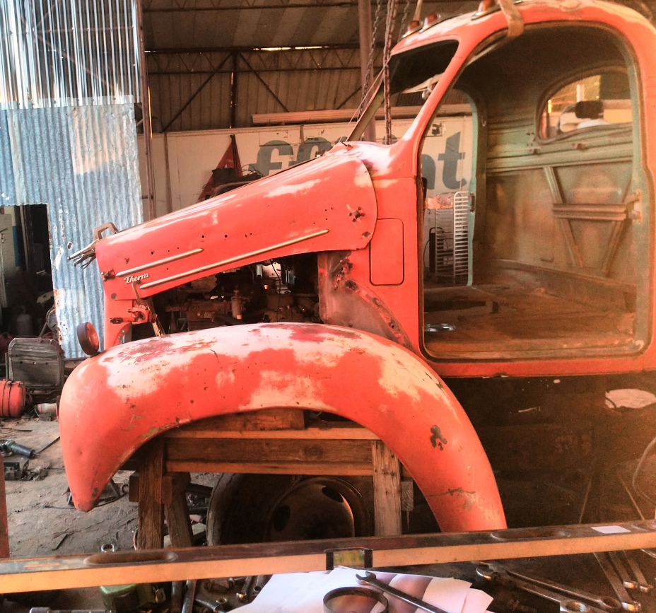

    I think I like this concept LOL
    Hate those rear fender mounts.
    I already have my cab this high

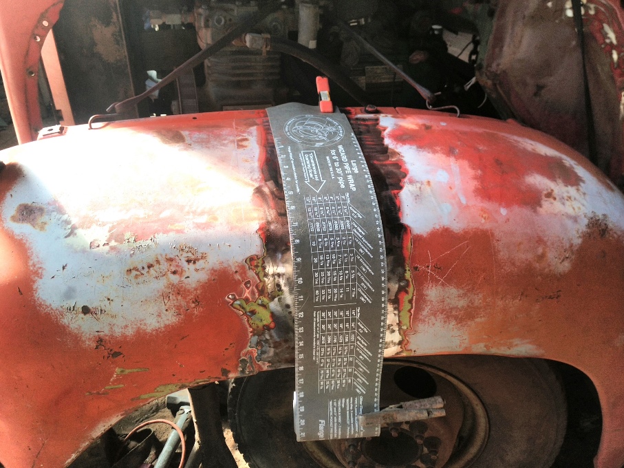

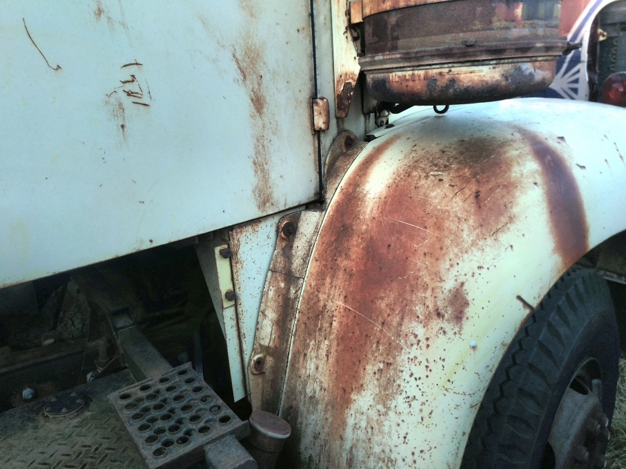

    Something has to be done to that fender.

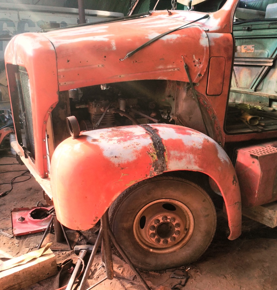

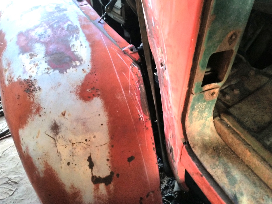

    Time to fit the shell together,I like to hold a gap at least as wide as the sheet metal is thick. but I may have gone a little overboard here.

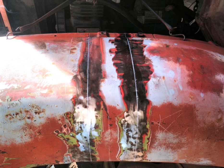

    But it turned out OK, I tightened up the curve of the hood a little too much will dela with that later. I cut 4inches out of the fuel tank I like how it doesn't stick out past the body now.

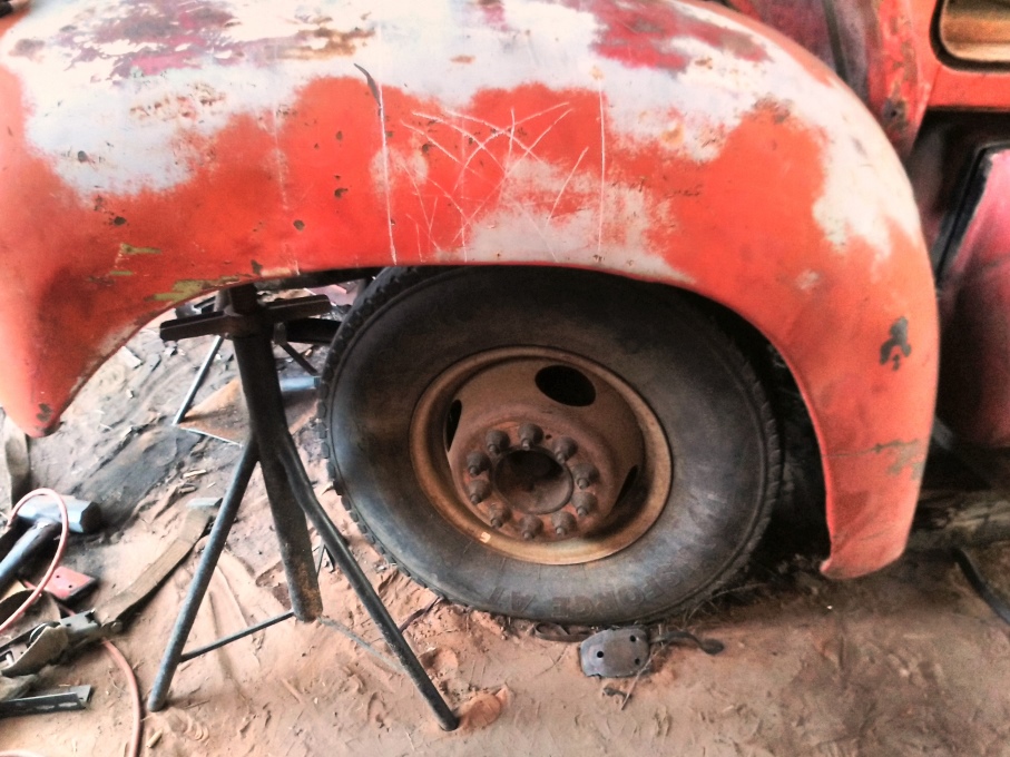

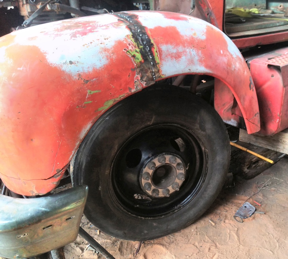

    Still need to do something to that fender and that tire and wheel looks way too small.
    Yep fender too long wheel too small

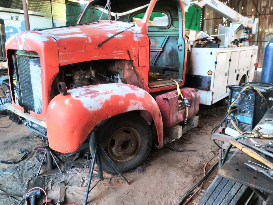

    Figuring out possible places to cut the fender.
    Will probably cut it here too.
    Cut here
    Much better still hate that wheel though
    That's better
