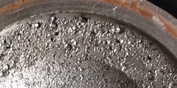

Armilite.. Thanks for your input, but this damage it not from detonation. I am sure you will agree if you look close. I did do a compression test when I installed it, 120 in both, which is 30 pounds low. I have learned since this incident that the company involved cuts chambers to reduce compression to avoid warranty claims from people using cheap fuel.
Attachment 18745
You can see the perfectly round impressions left by ends of the steel pins. The irregular shaped impressions were caused by bits of aluminum that were scrapped from the crankcase as the pins were forced between the crank and the case during their violent escape out of the engine and into the lake!

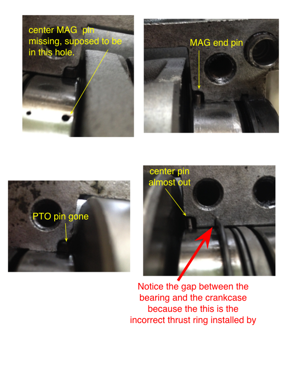

The damage was caused when two bearing alignment pics worked their way out of the crank bearings because the case halves were held apart by an oversized thrust ring that was installed by a big name PWC engine rebuilder. Whoever assembled the engine HAD to know they had something wrong as there was WAY too much sealant between the case halves.
Attachment 18744
I would not have even known the pins came out if one had not smashed the sparkplug closed. While it did run rough for a few seconds, I thought I had sucked up a stick or mud as I was running slow in the no wake zone. The second pin came out at speed and it instantly began running on one cylinder.
