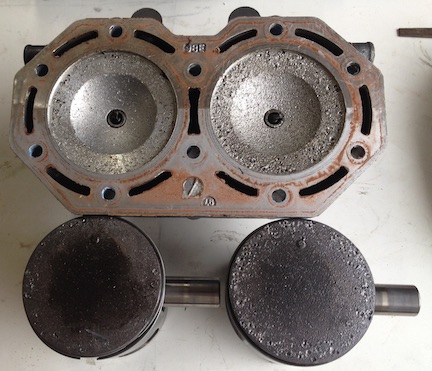

    I am rebuilding a Personal Water Craft engine. I purchased this rebuilt engine from a big name PWC engine rebuilder. I will never purchase anything from them again. The engine failed, due to incorrect parts being used to assemble it, damaging the pistons, cylinder head and cylinder walls. The damage was created by small locating pins that worked their way out of the crank bearings because the incorrect (too large) thrust ring prevented the case halves from pulling tightly together.

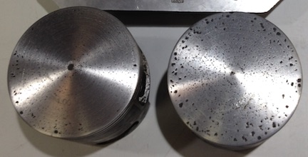

    I was able to hone the cylinders so they are still within the specifications. I have worked on the pistons, they will clean up. I will need to balance them when I get finished with that. I will be able to account for the “shorter” pistons with a thinner base gasket for the cylinder or cutting the head.

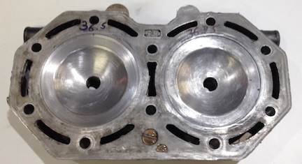

    I am currently working on the head. Since the engine was previously rebuilt and I do not trust the rebuilder, I could not be sure the combustion chambers were the correct profile to begin with. I purchased another cylinder head with one good chamber, the other chamber was damaged by what I suspect was detonation. Possibly due to an air leak in the crankcase. I will also be able to repair this head to use on a spare engine I am also building
    —good chamber photo

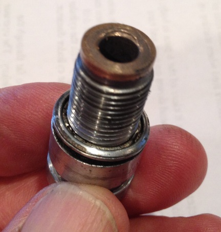

    Making a form tool to fit the chamber.
    I polished and waxed the good chamber. Then removed the ceramic electrode from an old spark plug. Turned the ground electrode off the end. Then bored the plug to fit a bronze bushing inside.
    —Spark plug photo

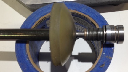

    Then I made a mandrel by cutting the head off a 1/2” bolt. Threaded 2 nuts on the end and jammed them tight against the shank of the bolt. The nuts give the resin something to grip to resist torque. Then turned the end of the bolt to fit the bushing I put in the spark plug. With the plug screwed into the head, I leveled the head so the resin will flow into the chamber level. Then inserted the mandrel into the bushing. Then mixed and poured polyurethane resin into the chamber to create a form tool with the correct shape.
    —form tool photo
    The problem-
    After the resin cured I was able to attach some sand paper to the form to remove the dings from the chamber. The process worked OK, but not great. I was quickly and easily able to remove the dings from the chamber. However it I am not able to get finer grades of paper to conform well enough to the shape of the tool. The little wrinkles in the paper causes grooves in the chamber. It needs to be smooth to prevent detonation.

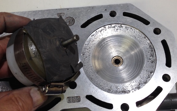

    — chamber and tool photo
    After I find a good way to finish the chamber I can use that technique to clean up the squish band. Then CC the head and cut the surface as required to bring it back into specification according to how the pistons and deck height come out.
    I have tried valve grinding compound on the bare from tool, it might work, but I am not able to find various grit sizes here locally. If anyone has other suggestions for a better way to get the abrasive to fit the form tool….I am listening.

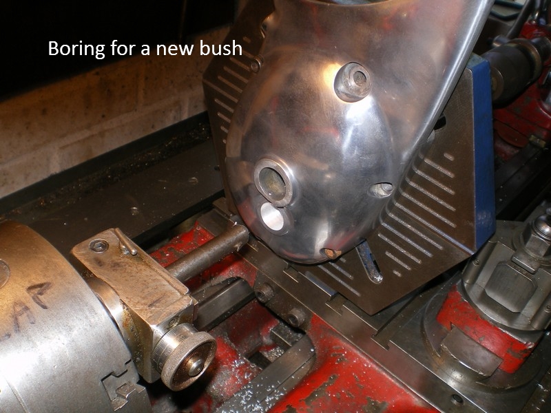

    Hi Hemmjo
    Wow sure made a mess of that engine.
    Unfortunately any form of purely circular lapping will always leave a grooved finish due to trapped debris and media, but you can certainly remove metal to a point. You could try gluing thin strips of emery radially to get over the wrinkling, that may help to give the debris somewhere to go, after that for me it would be down to hand finishing, a mirror finish is not necessary or even desirable, just smooth. Now I know what machinery you have, after finishing the chamber you could machine the squish band using an angle plate on the lathe crosslide and a boring head.
    I have done more than a few jobs in this fashion using my drill table as a large angle plate.
    The only problem I can see then is balancing the combustion chamber volume, you can do this using a measuring burette and paraffin but it takes a long time.
    You seem determined so I am sure you will end up with a usable engine.

    Perhaps using some burlap instead of sand paper. Impregnate the burlap with your honing compound?

    To improve the use of abrasive sheets I suggest cutting the sheet in the following manor.
    1) Cut a disk with a diameter that covers your form tool plus enough to clamp on.
    2) Cut triangular slits (maybe 5 - 8) out of the disk. The slits should be oriented with the apex near the center of the disk and the base (shortest side) of the triangle on the circumference of the disk. Size the slits to get maximum coverage of the form, without any overlap.
    The finished abrasive disk will look similar to a daisy flower (with petals) and should improve your metal removal.
    Besides the flower petal approach, I suggest using an abrasive sheet with Pressure Sensitive Adhesive (PSA) on the back and eliminate the hose clamp altogether.
    "3M Stikit" (or equivalent) disks w/ silicon carbide abrasive are easily available on-line in a full range of grit grades.

    Just a suggestion, but you could use your resin dome and some cloth with polishing compound on it. Leave out the center pin and oscillate the drill as you turn it. That should help alleviate the circular grooves in the head. What the others here said makes a lot of sense, as taking too much metal out of the head can change the size of the combustion chamber, but if you use a fine cut polishing compound that should slow down the amount of metal taken off when compared to emery cloth or sandpaper. Just a thought.

    PERFECT!! Thanks for the input. I used several of your ideas.
    In regard to chamber defects. This is not a racing engine so I do believe that some defects are OK but sharp edges are bad. Sharp edges stay hotter and can cause detonation if conditions are pressed to the limit, for whatever reason, most typically a lean condition or even bad fuel.
    I cut the pilot off the end of my tool. Then faced the end of the shaft so it was a little up inside of the resin dome. Stretched a piece of shop rag over the dome and secured it to the shaft with a hose clamp. Used my lathe instead of the drill press so I can slow the speed way down. Covered the ways on my lathe with a shield I keep on hand. Dipped the tool in water to soak the rag. Smeared some valve grinding compound the rag. The "osilated" the head around as the dome worked in the chamber. It took only about 15 minutes for each one. They look great.
    The reason that I purchased that additional head with the good chamber was so I would know how many CC's and that shape the chamber should be. As I have learned from other sources this company that rebuilds most of the PWC engines in the USA, cuts the chambers to reduce compression, so their engines will be less likely to fail during their warranty period. Both of the chambers on the damaged head from my engine were 37.25cc before i started. I have not checked them since I cleaned them up, but I will before I work on the squish band. I will make them the same before I work on the squish band, and then again after that. The undamaged chamber on the head I purchased for reference was 36.5cc.
    Again, thanks for the input, I will send a photo when the head is finished.
