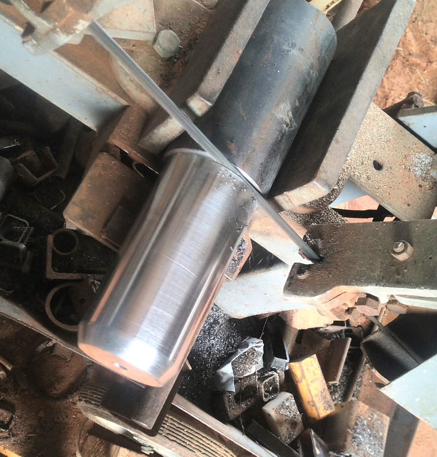

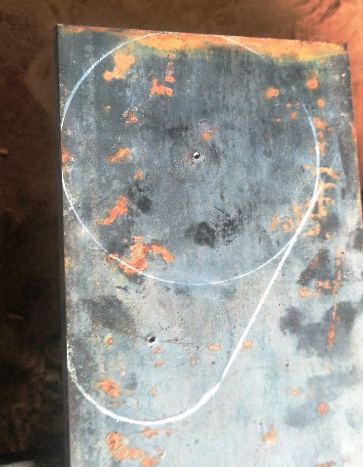

    this is how I made a 3" diameter 6" long dog eared clevises pin
    first, I turned the bar down to 3"-003"n and cut it to length

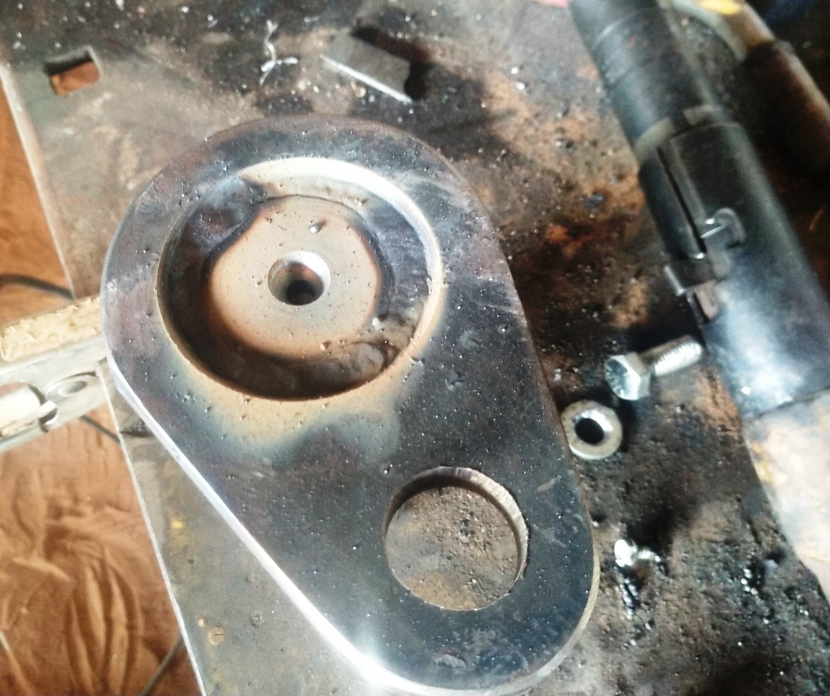

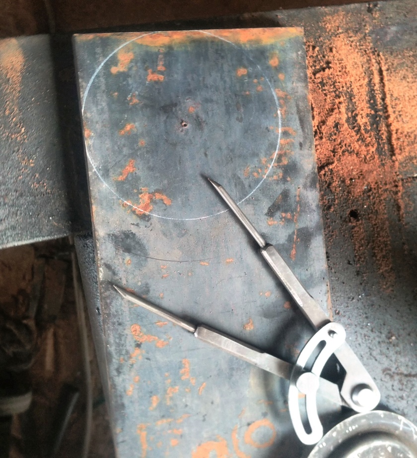

    then laid out the dog ear

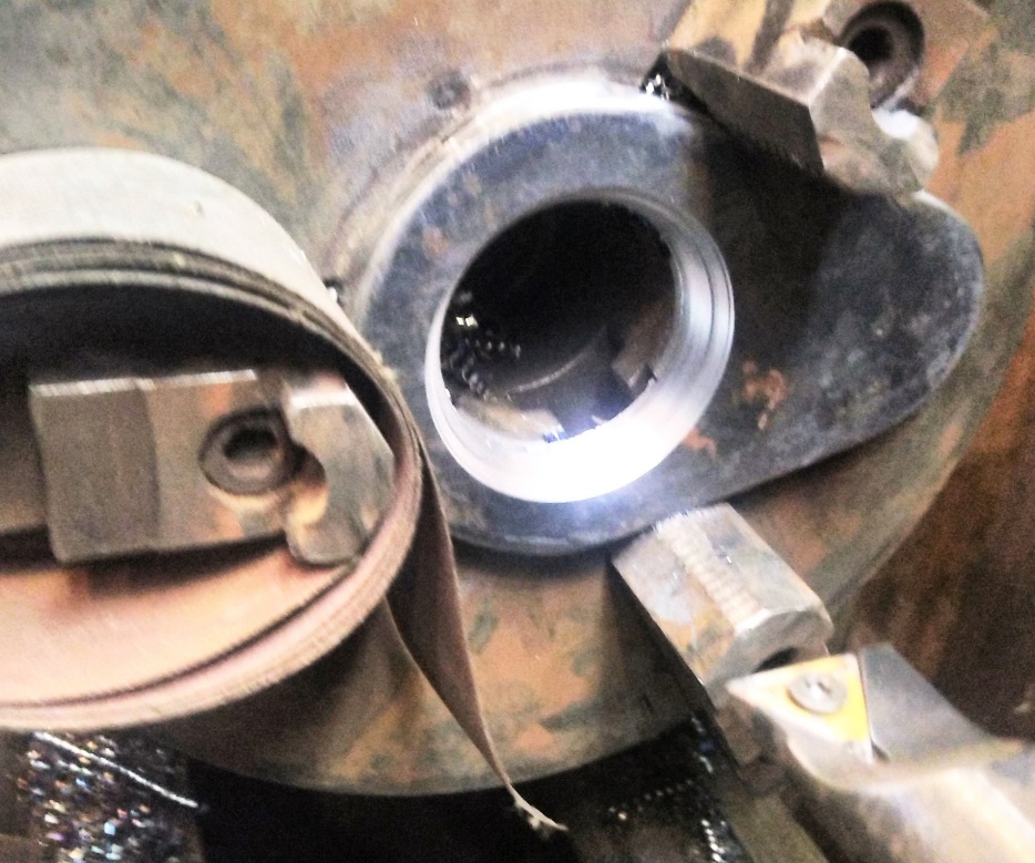

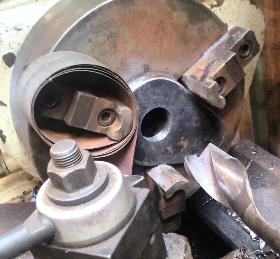

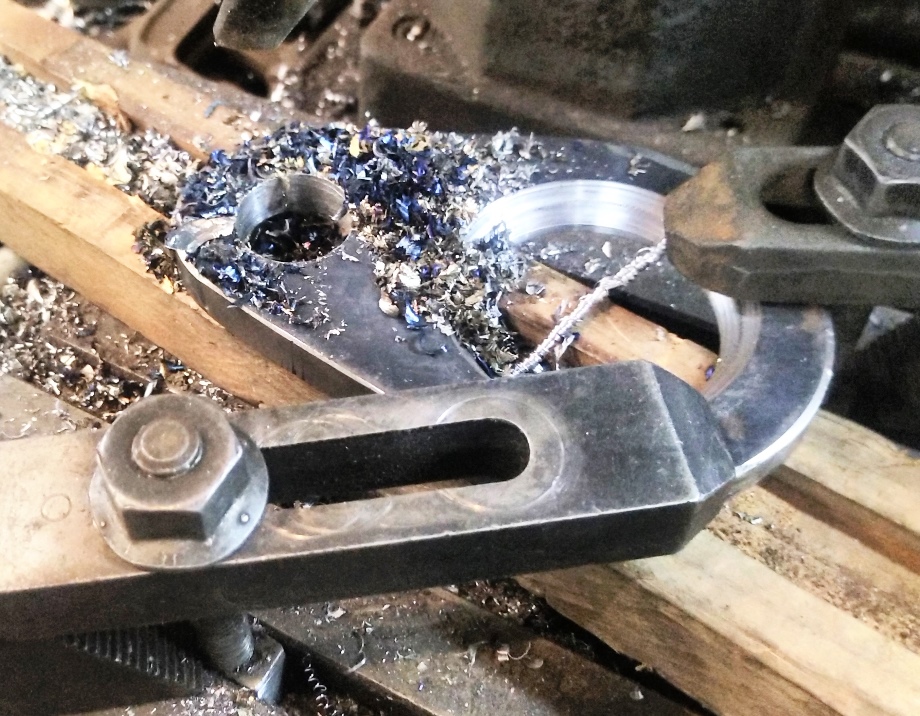

    I will do nearly anything to keep from having to change from 3 jaw to 4 jaw or vice versa My lathe has the short nose spindle so the chucks are held on with bolts and a real pain to change
    next to drill the 1 3/16" hole

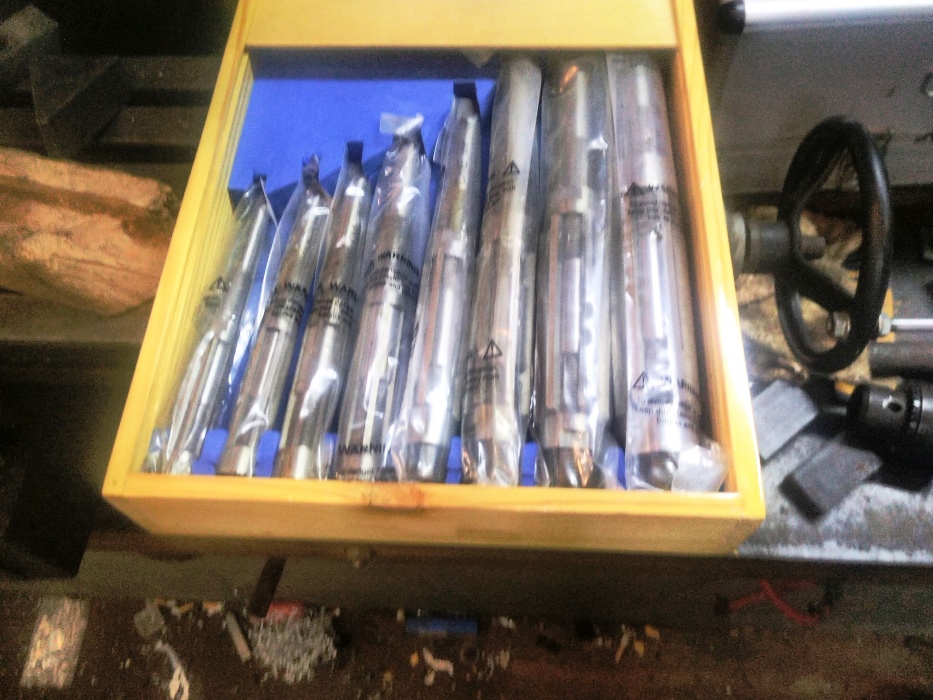

    Even had a chance to use one of my new reamers

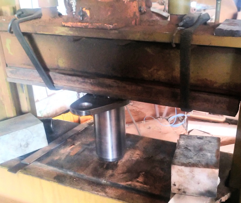

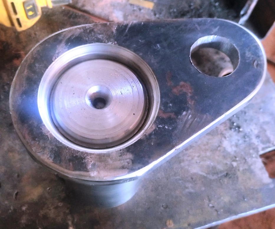

    I pressed the ear onto the pin

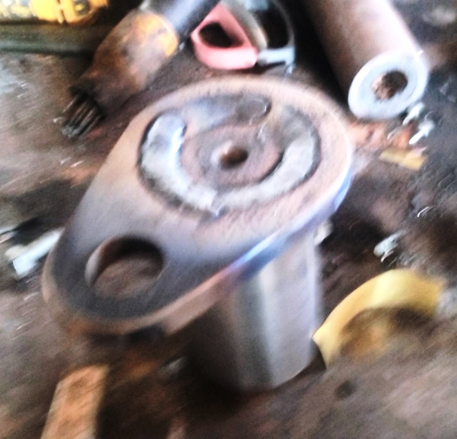

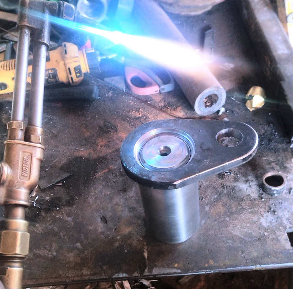

    Then since there is a thickness issue between the 3" pin and the 1/2" ear to insure proper weld fusion it is always best to pre heat very thick metals before welding

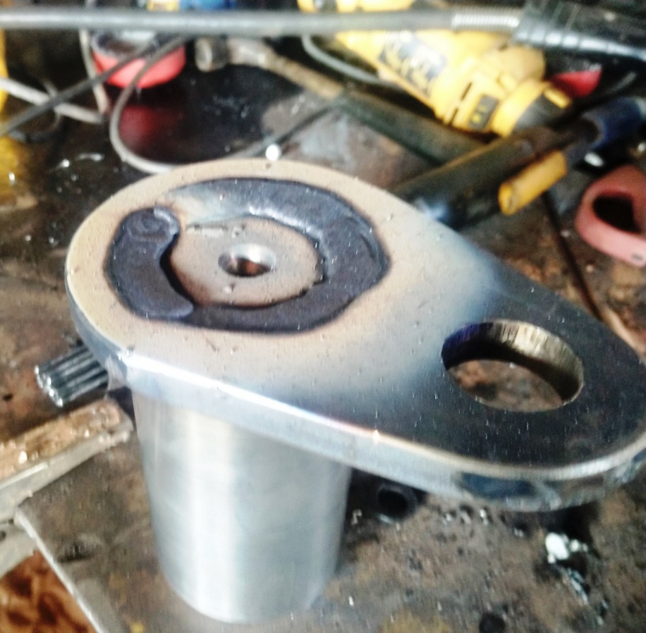

    First pass
    Needle scaled the flux off between passes waited a minute between passes
    last pass
