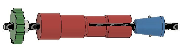

The first one uses an expanded collet based on the Myford manual winding handle.

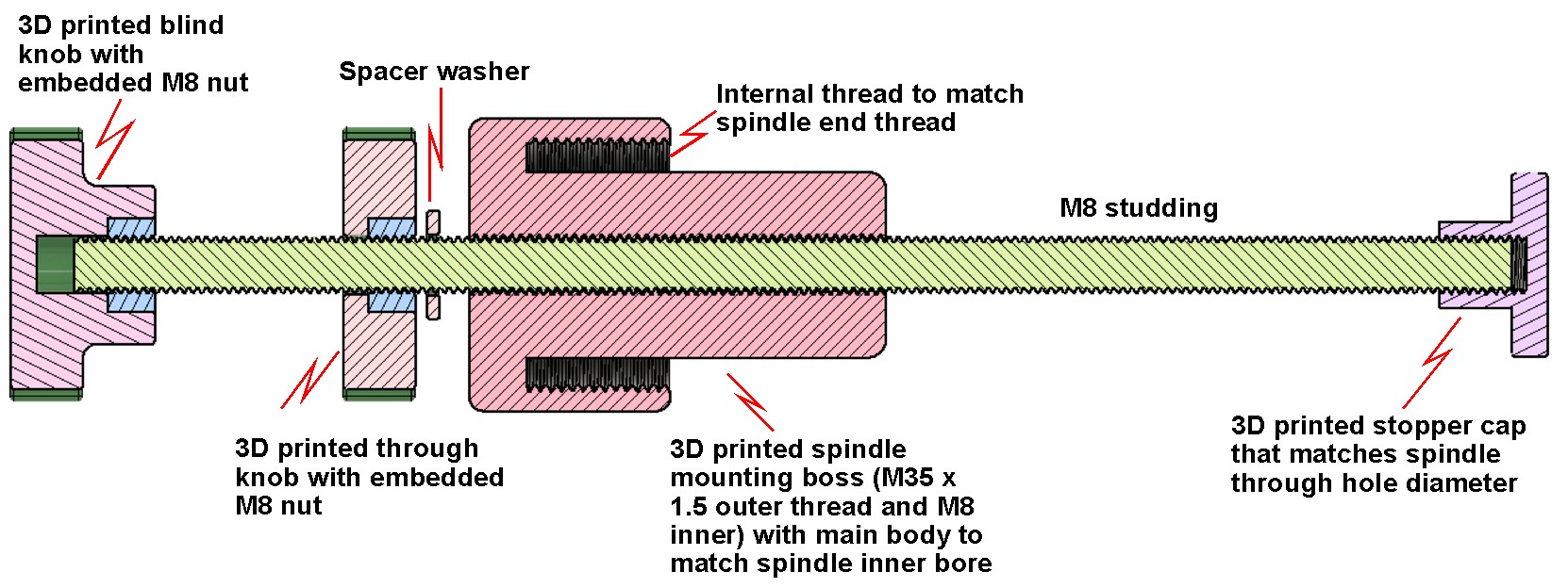

The second is specific to the Myford Super 7 Large Bore and uses the M35 x 1.5 threaded end on the Myford spindle.
This could be adapted for the standard Myford bore (if I knew the relevant dimensions).
Both use similar 3D printed components mating with M8 fastenings.
The STL files for the parts are available for download from my blog
