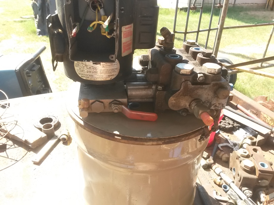

To build another was the easier choice First I started with an old automotive lift power unit off of a larger lift actually it was one I had removed from an elevator I built 20 years ago when the coupling went bad a few years back.
I made a new pump to motor coupling "see https://www.homemadetools.net/forum/...644#post139709

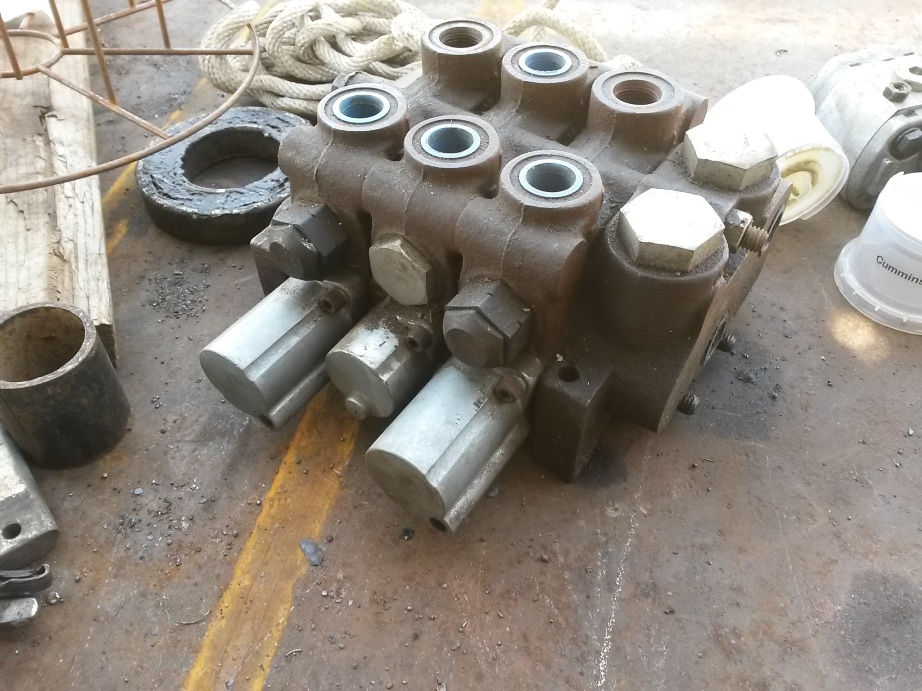

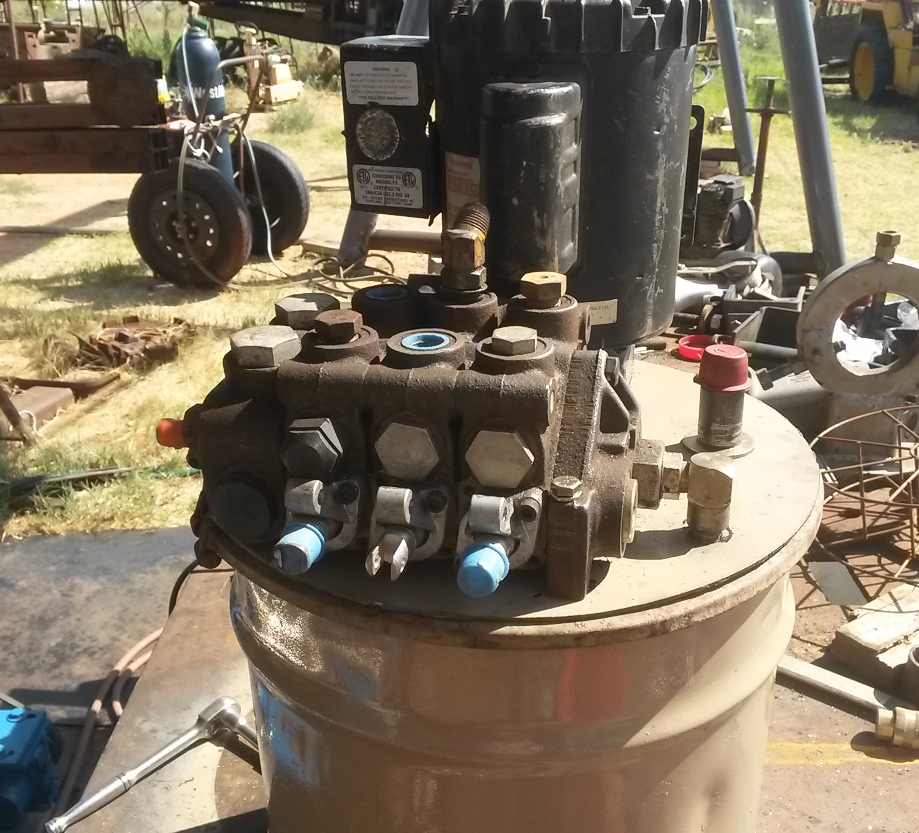

Then I inspected several pumps that I had and checked the motor, then located a 4 way valve the one I decided to use is a 3 bank valve I will cap 2 of the sections for now but may need them when I use this power unit to test other equipment.

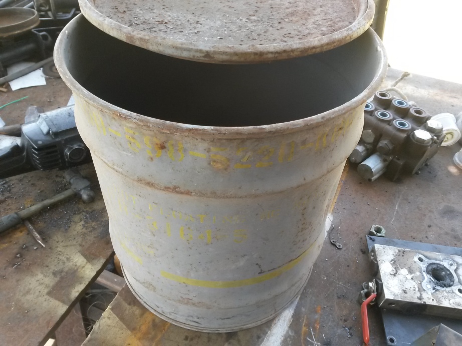

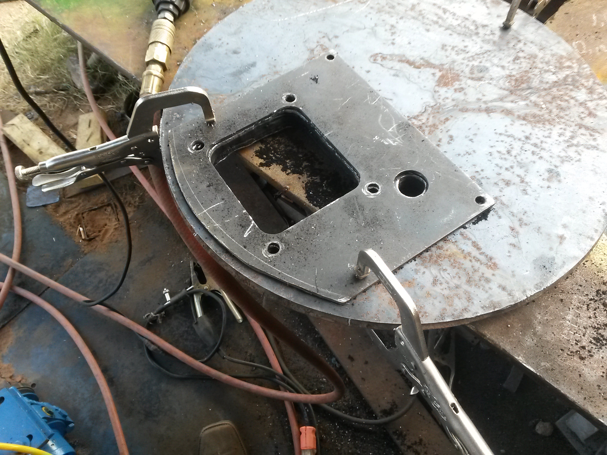

next was to decide on a tank the 6 gallon plastic tank didn't fit my design criteria, so I settled on a 15 gallon steel drum it has a good diameter to height ratio being almost the same in height as in diameter.

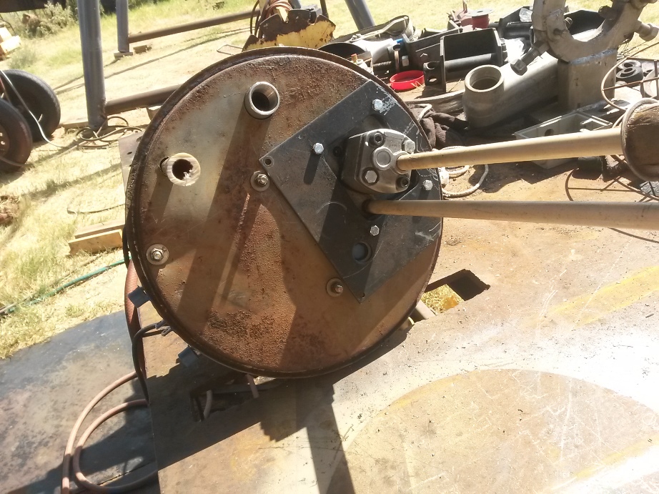

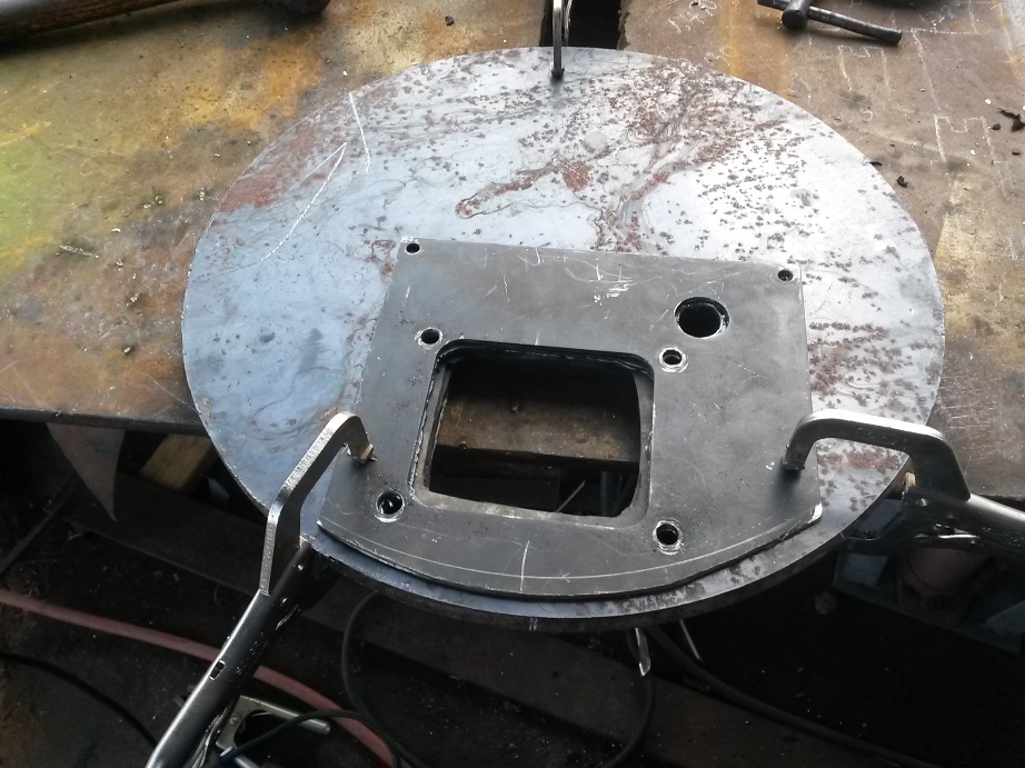

I couldn't just mount the pump and motor directly to the top as the metal was too thin for my liking so I cut 3 old truck mud flaps to fill the depression in the top Then I needed to cut a round plate to cover these with and bolt through everything.

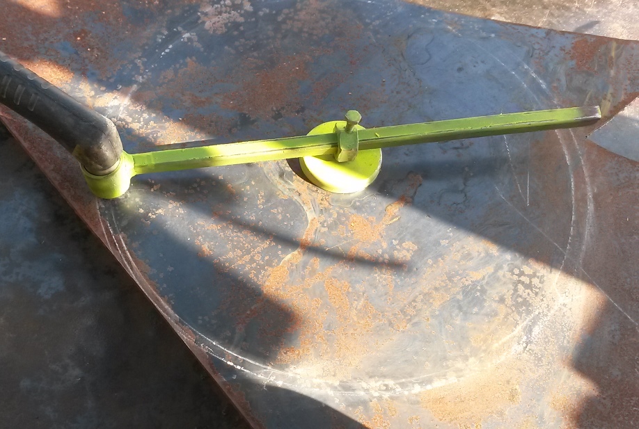

this was why I made the https://www.homemadetools.net/forum/...le-guide-74775 to cut out the round piece
here are some assembly pictures I still need to make up 3 hoses tomorrow if I have the correct fittings then will have to wait until I need to make a trip to town to get the oil.
