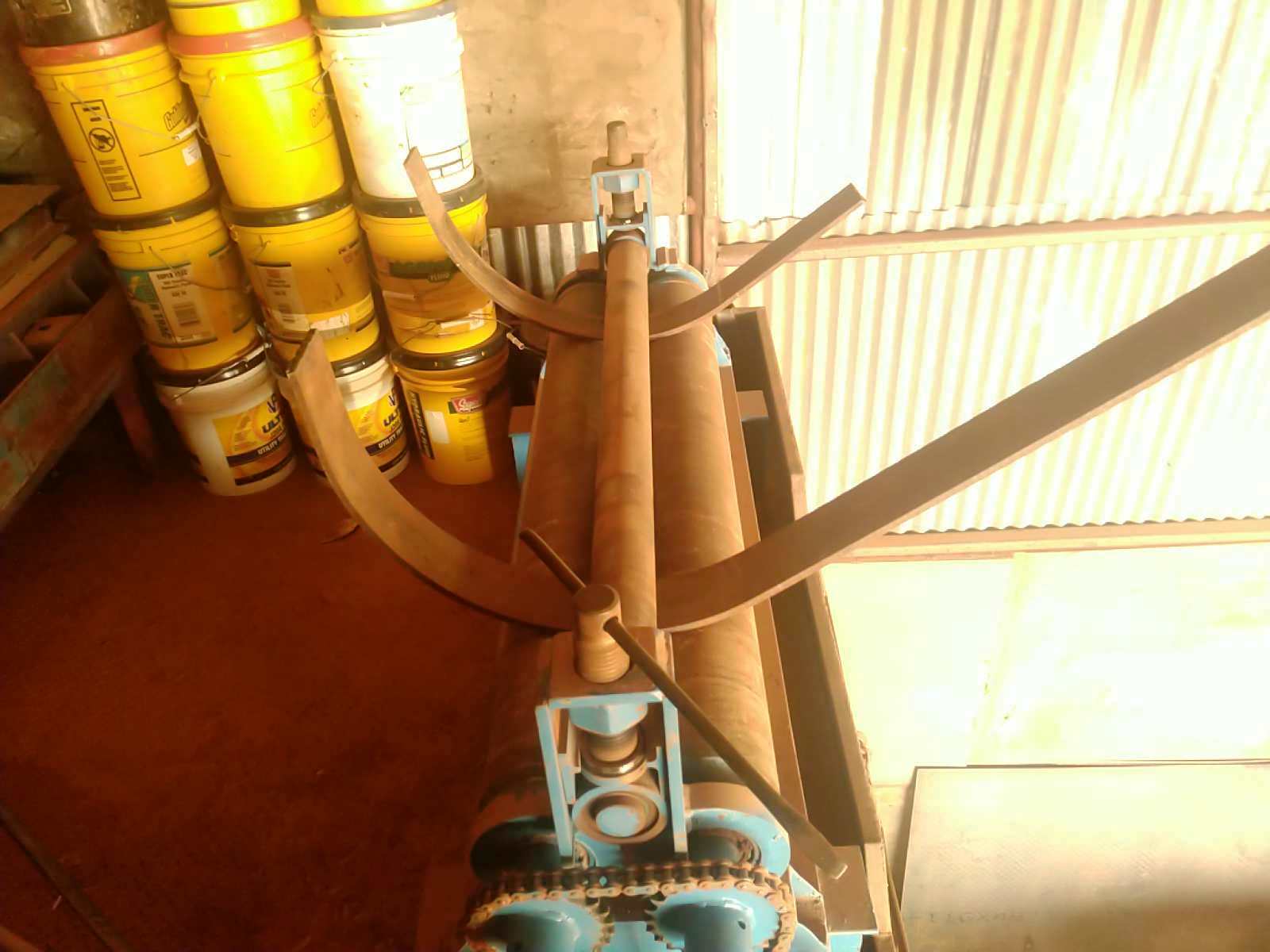

I knew going in that the speed was going to be faster than I wanted also by reducing it to another 3 to 1 or 4 to 1 it will multiply the amount of torque available.
Although had I a 2 grove large pulley it would have helped as well I cannot stall the hydraulic motor as it is right now the belt will slip.
I'm pretty sure that I could possibly roll full width 7 ga or 3/16" plate once I reconfigure the reduction system and possibly add an idler pulley or 2 to get more wrap on the small pulley but will probably go to a 6" diameter one to mate with the large one which will reduce my ratio then make up for it with another jack shaft to hit pair up to the motor.
Ultimately I would like to come up with a 4 or 5 to one epicyclical drive to mount directly on the motor and come off of that with the 6 inch pulley.
I have 6 more of those hydraulic motors and now that I know their capacities I may some day decide to build the mini dozer I designed years ago using 2 of them in each final drive unit and 2 of them for a PTO or I may make a wood chipper with a couple of them who knows they're not going anywhere stashed away in my storage.

While working on a new repair project I decided that I was going to need to roll a couple strips of 3/8" thick 4 1/2" wide T1 steel Now the grade of the metal I have has a minimum yield of 100,000 PSI and a Brinell hardness of between 235 & 290 RC 26 in its natural state.
So a pretty good work out for my plate roll I figured. Actually due to there only being 9 inches total width the roll acted like it was no big deal.
This was one of the reasons why a built it like I did
Attachment 40126
These 2 strips would be about equal to a single piece 1/8" of hot rolled mild steel 54 inches wide
