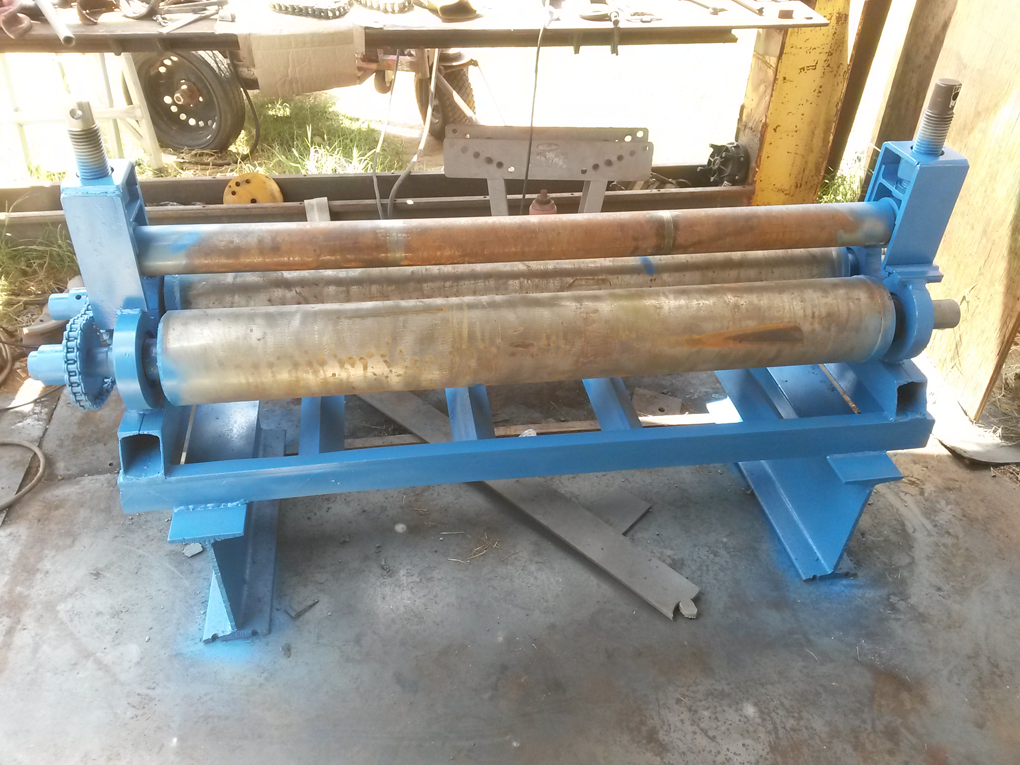

For quite a while now I have been working on my 54" 10ga plate roll
it has 6" pipe main rollers and 3 1/2" solid bar top roll

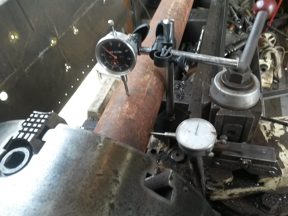

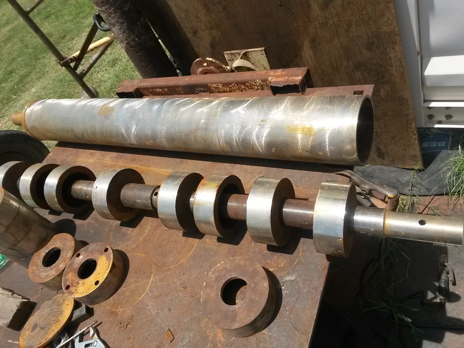

Started off with 6" seamless Sch 40 pipe that had 1 end already on it just had to trim off 50 lbs of steel then turn the pipes
Attachment 30648
Attachment 30649

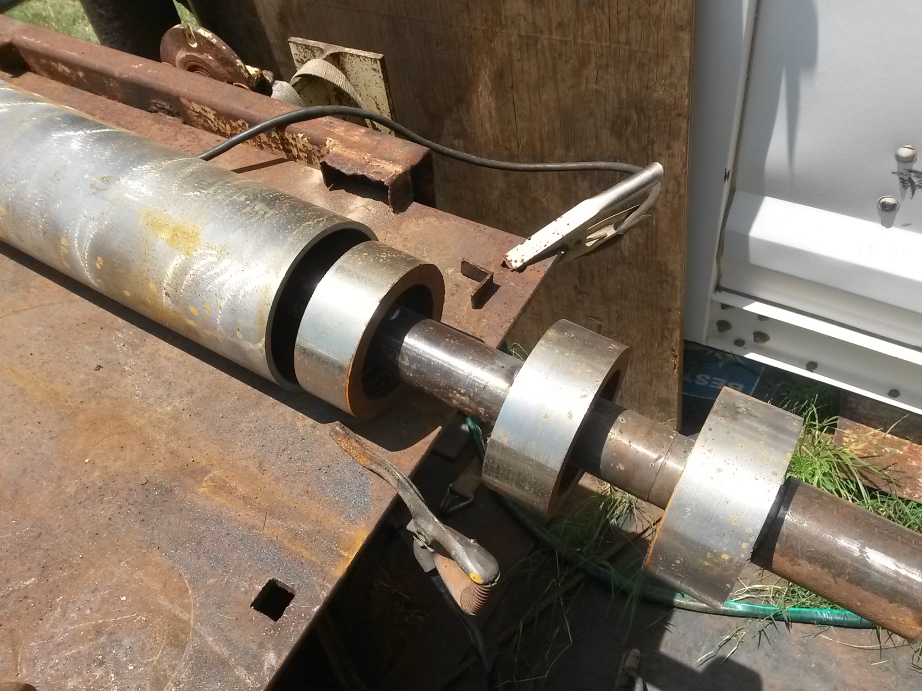

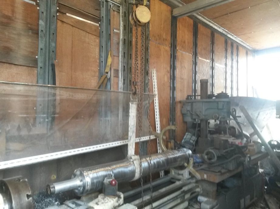

Then machined 16 2 1/4" thick disks to go inside and a center shaft to stiffen the main rollers
Attachment 30651
Attachment 30650
Attachment 30652

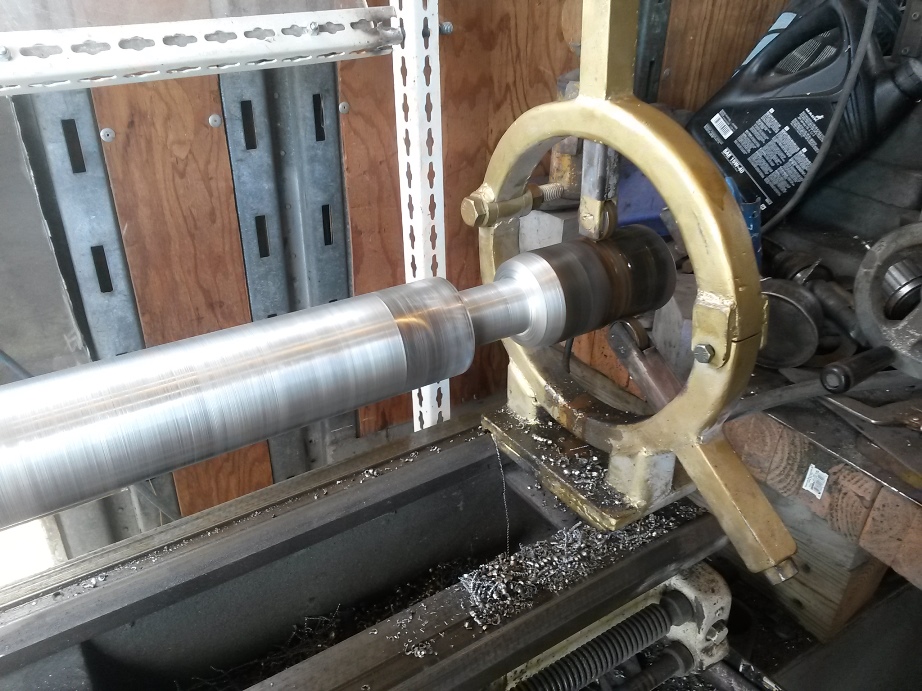

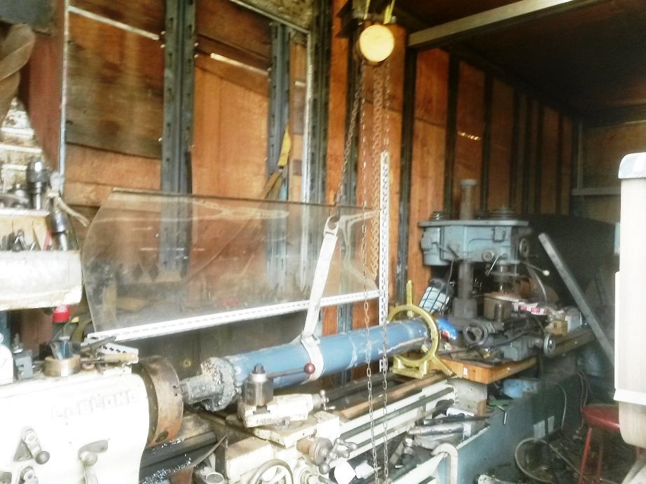

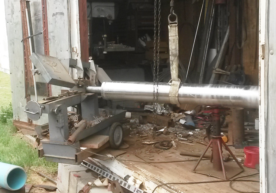

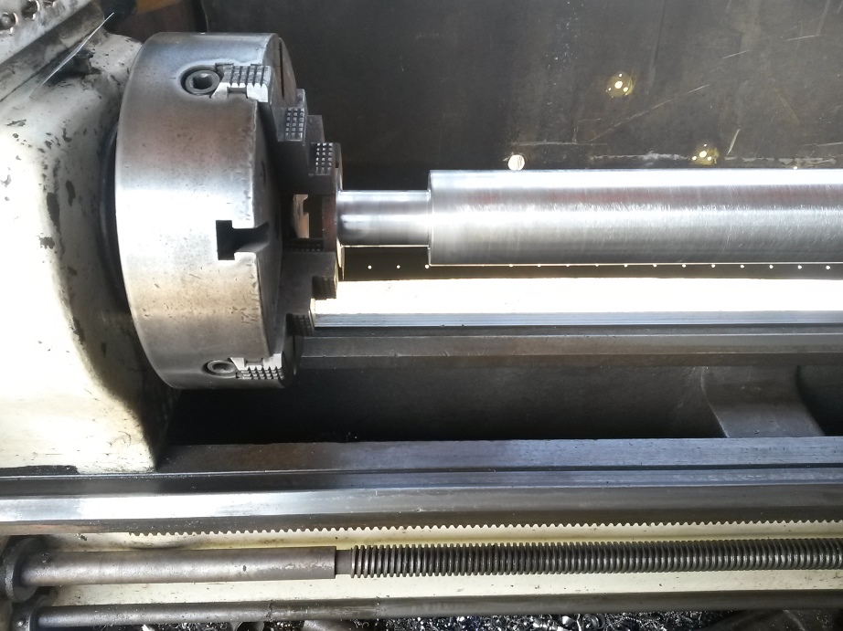

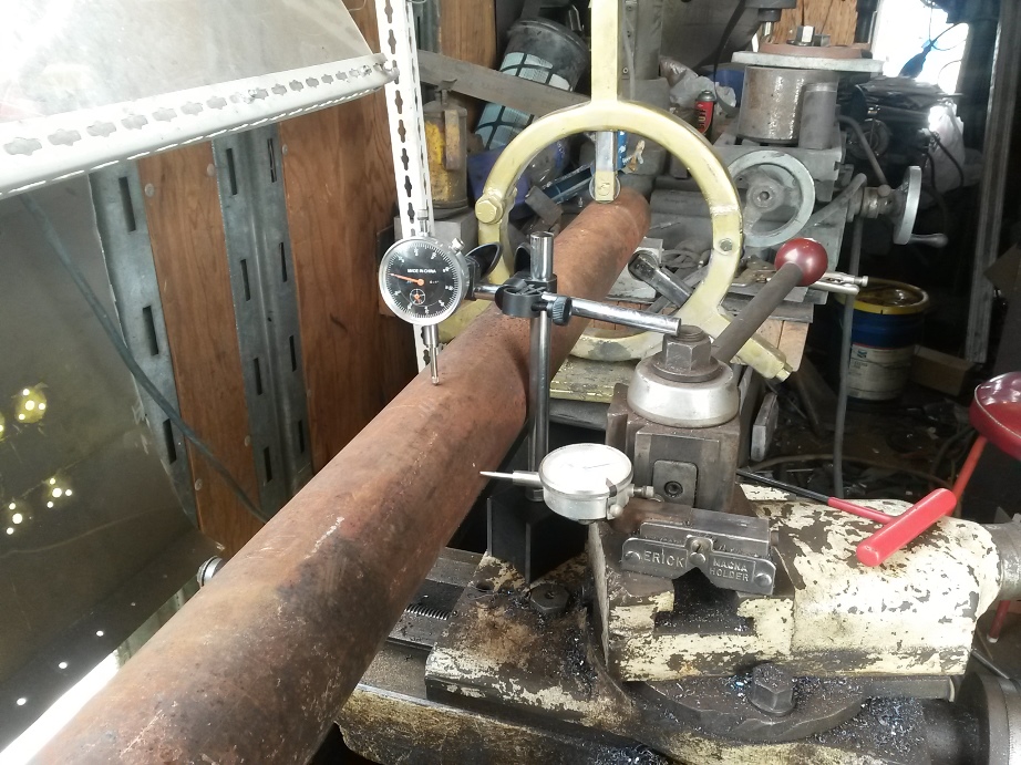

Then I had to machine both bearing ends on the top roll blind since my lathe is barely long enough to hold the shaft.
That and once I had it dialed to "0" "0" O didn't want toe move it

I just cut the ends off in the band saw for the pipes and the top roll
Attachment 30657

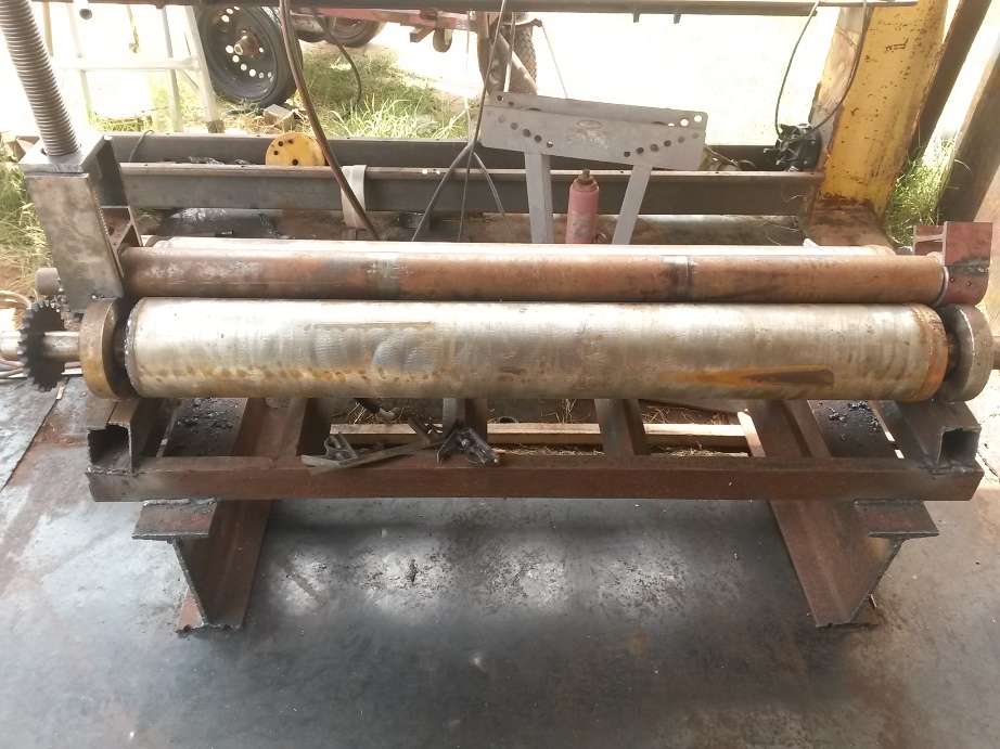

next I started assembling
the frame is an old trailer ramp with 12" I beam for the legs
Attachment 30660

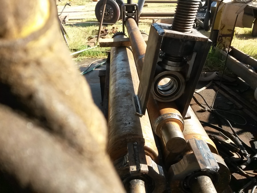

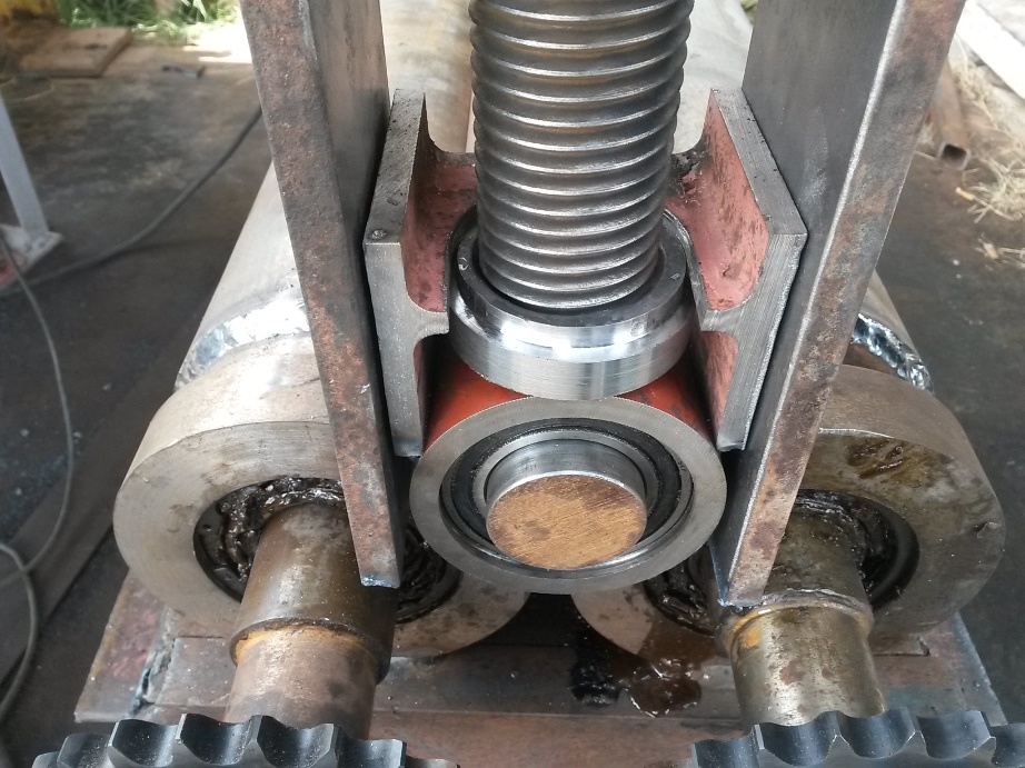

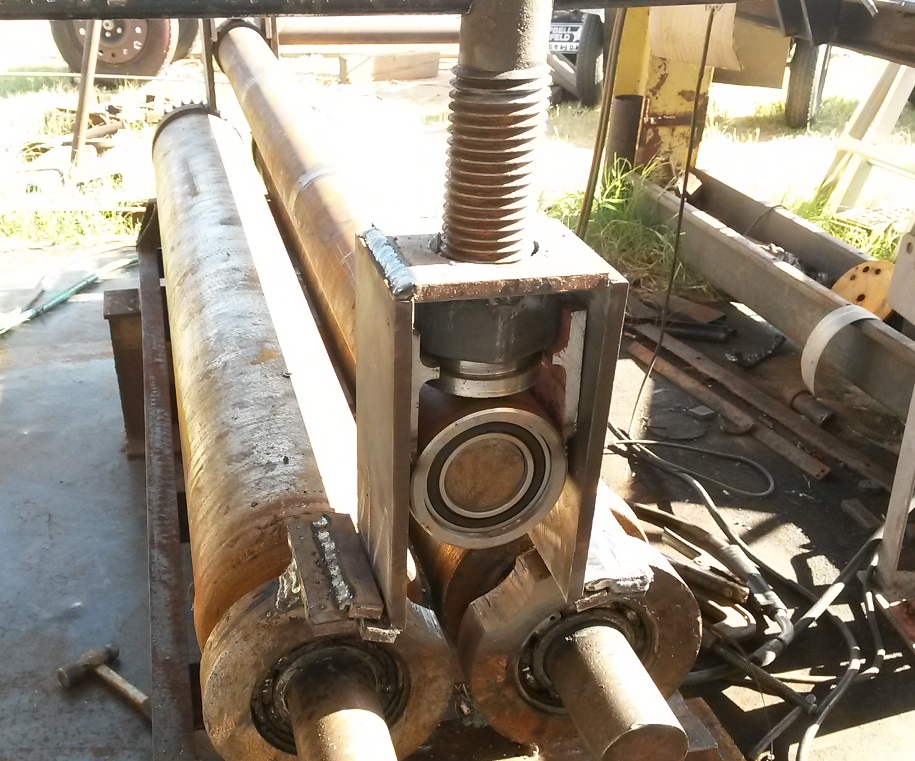

Next is the top roll mounts
Attachment 30661

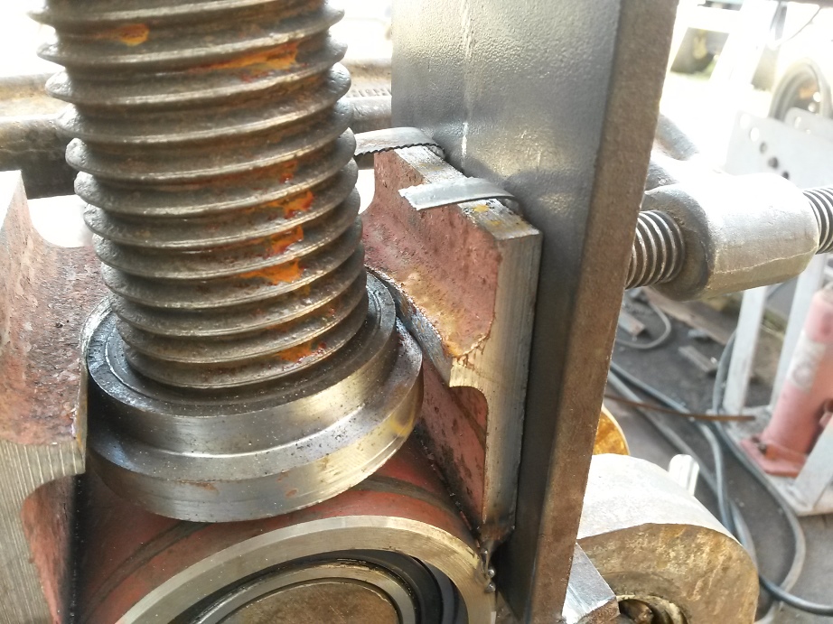

I used a couple pieces of a brolen bandsaw blade to set a clearance for the bearing housings to slid up and down
Attachment 30662
The down force screws are 2" B7 stud grade all thread. I turned 1 nut then split it to serve as the stop collar to raise and apply down force to the top roll The bearing housings are just some scrap cylinder stock I had
One end is made so I can slip it off when rolling complete cylinders
the slides are angled so as to cause the force to keep them held tight and not spread
Attachment 30663
Attachment 30664

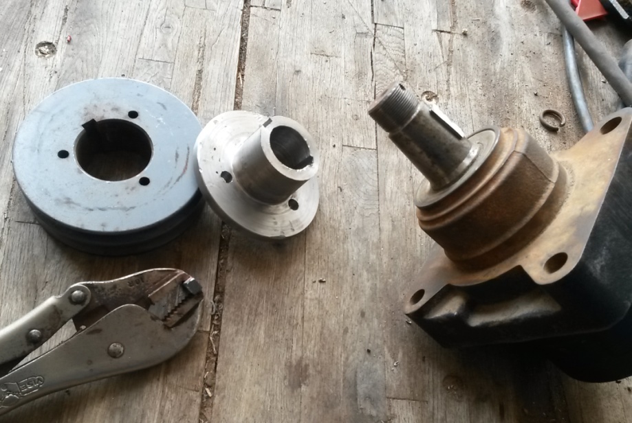

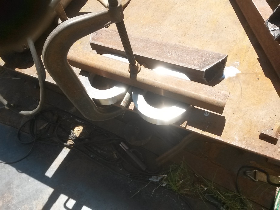

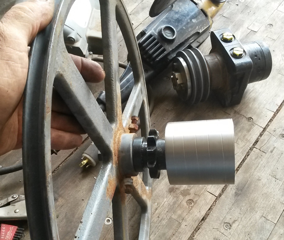

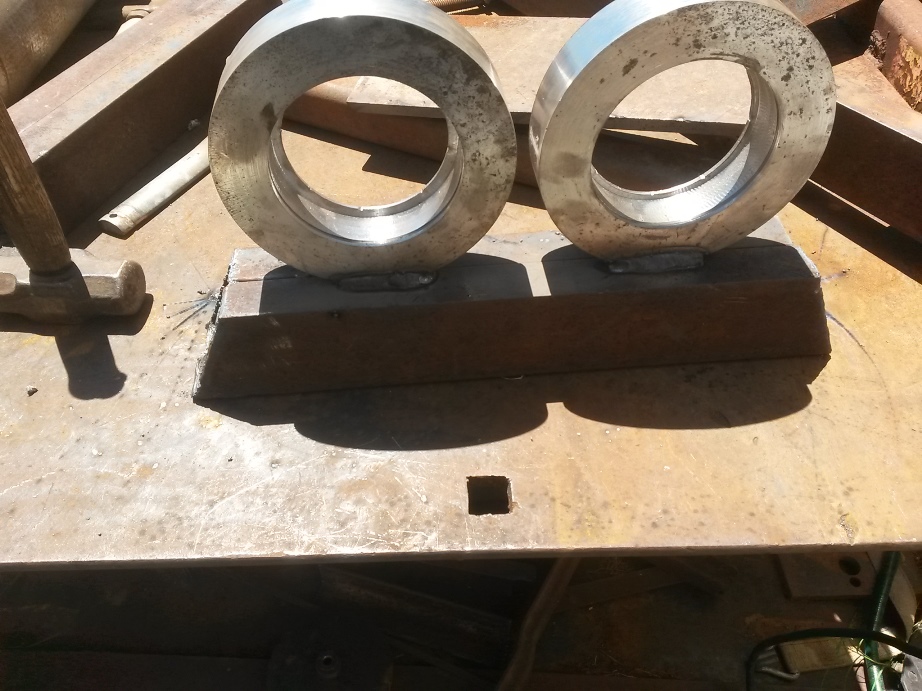

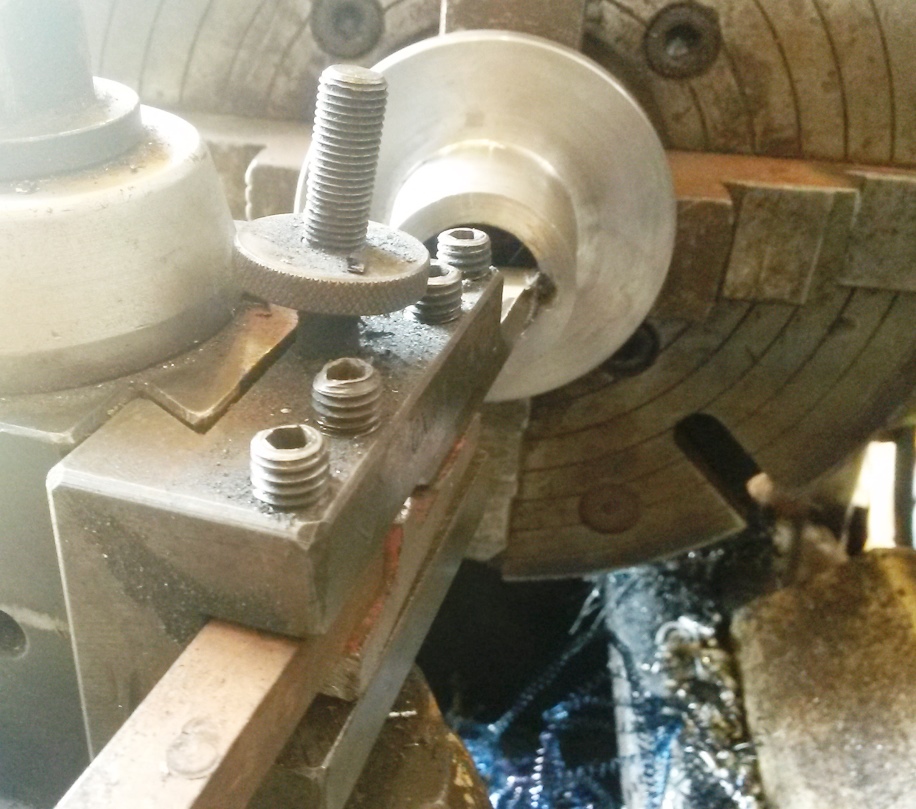

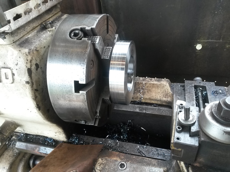

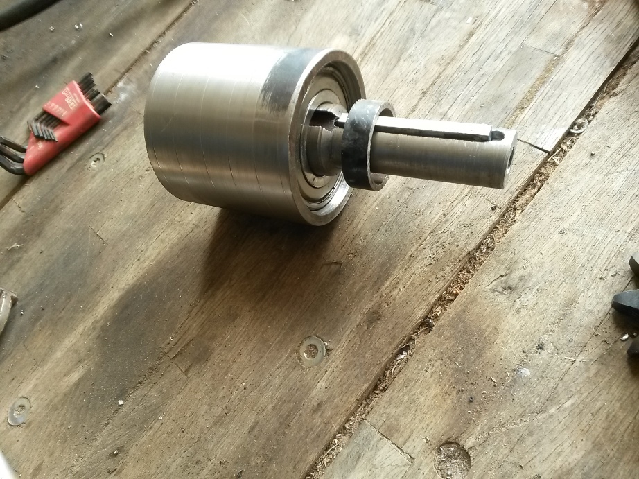

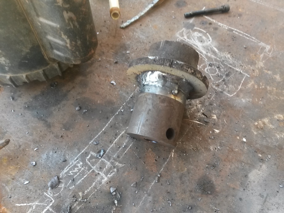

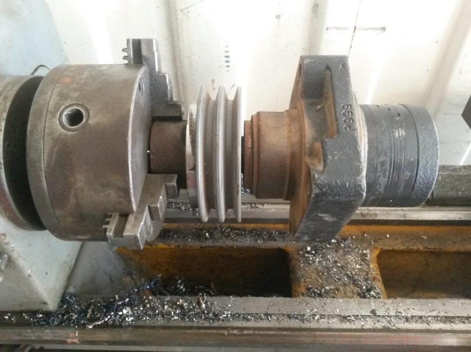

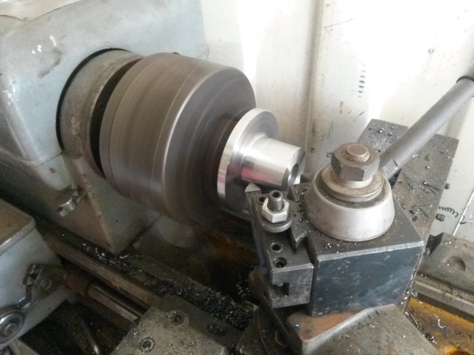

Then I had to make a drive adapter for the hydraulic motor to mount the pulley on
I started out by welding a round plate to a cylinder and tacked a sacrificial piece on the opposite side this way all machining could be done without removing the work piece
Attachment 30665
The machining was done on my little Sheldon 12x36 lathe
there is a taper to the inside and a taper on the outside 1 fits the pulley the other the motor shaft
Attachment 30666
Attachment 30667
To make the keyways I milled the outer one then chucked the piece in my Leblond 17x54 I used the tool post and carriage as a shaper to broach the keyway

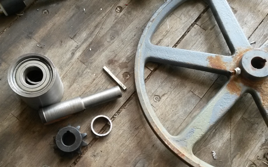

Next I made a jackshaft and bearing housing for the pulley to sprocket transition
Attachment 30670
It has a zero space stack up so no movement side to side is possible
Attachment 30671
Attachment 30672

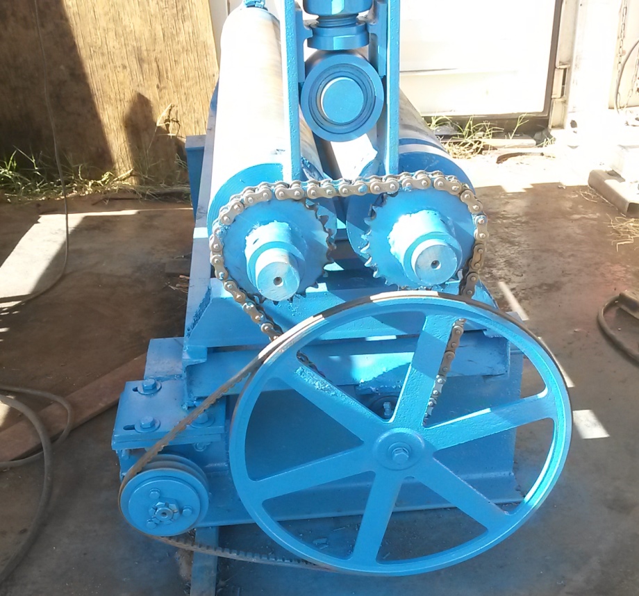

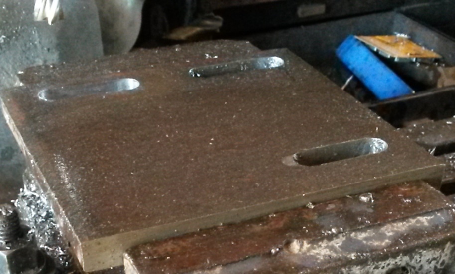

Next I had to make an adjuster plate to mount the hydraulic motor on
Attachment 30673
Attachment 30674
The roll is ready now b ut the power unit I had planned on using is AWOL either that or it is buried all the way to the front of one of two trailers so now I have to make a power unit or wait until Bob shows up and plug into his truck before I can use it
Anyway a little about the specs of the roll
54" max sheet width the main rolls are on 8" centers so this is going to limit the gage thickness of rolling a 4 ft sheet to around 10 ga possibly 3'16" if I want to roll back and forth many times.
the 2" down force screws can develop 30 tons of force each but that would mean having to use a long cheater bar on them.
the top roll is mill shaft out of an old cotton mill so I have no idea tis grade other than it was hard and free machining similar to stress proof or 4130.
Yep can never have machines too large, because I never know what I might need to do with them.
the first job for the roll is to roll some 10 or 12 ga into cylinders then make air tanks for a 1927 chain drive Sterling truck

the plate roll is painted with the KBS blue top coat from an aerosol. hard as nails and 100% UV stable.
