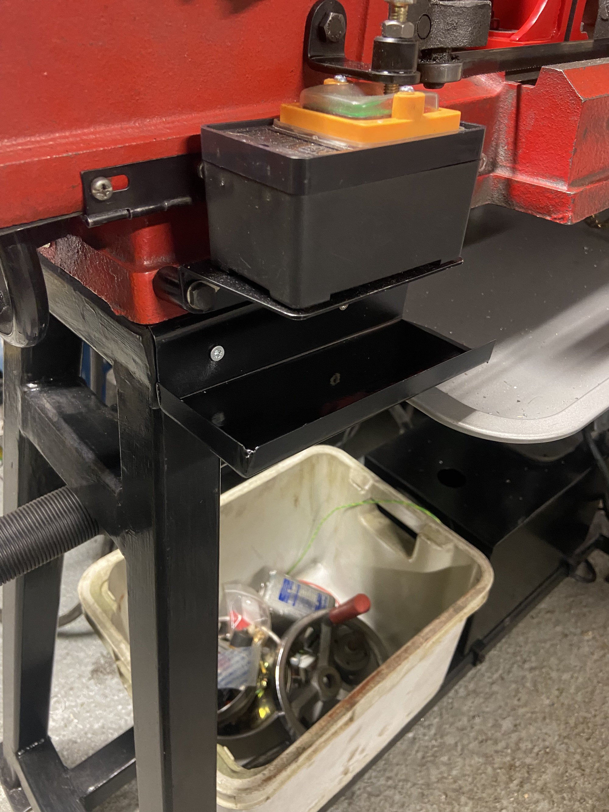

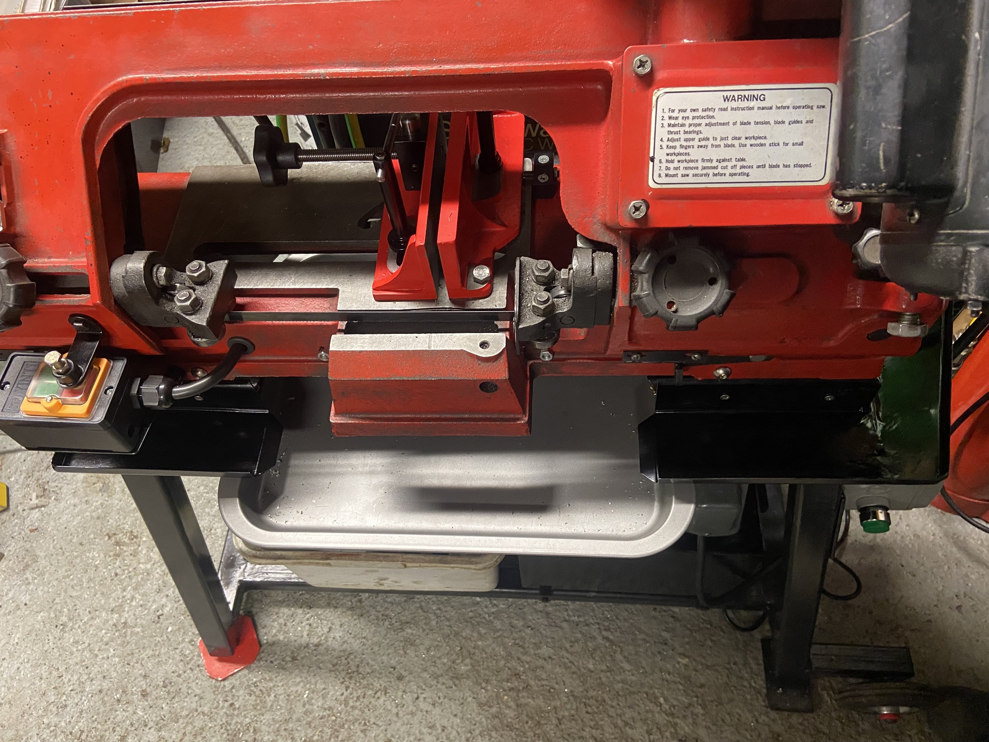

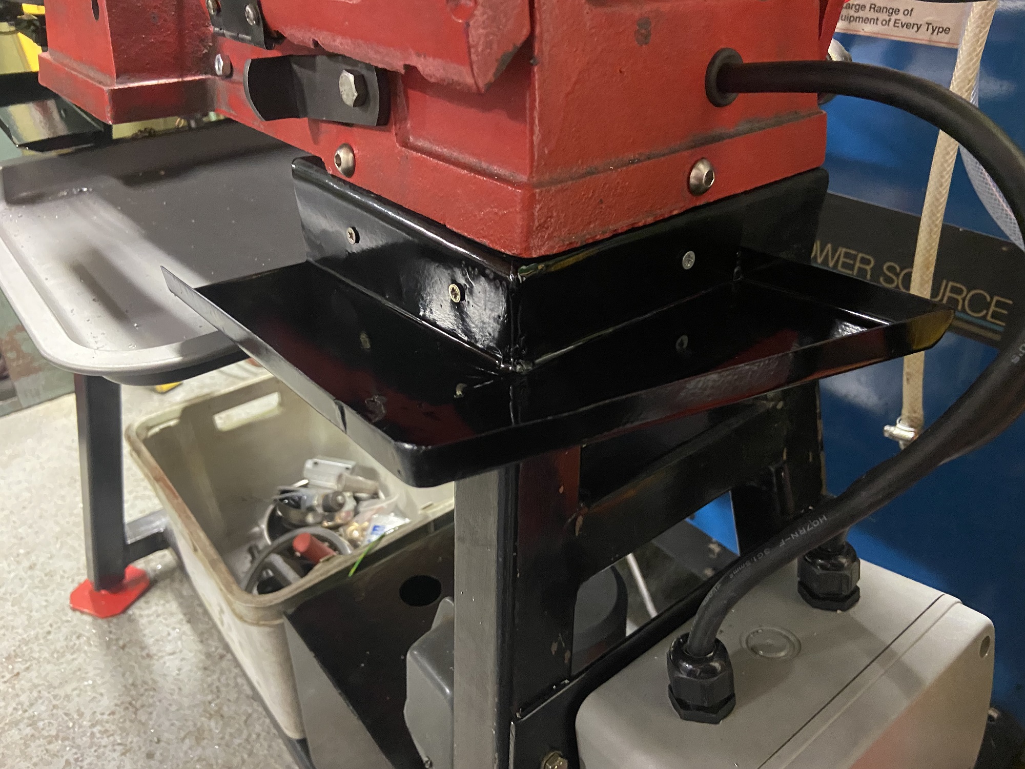

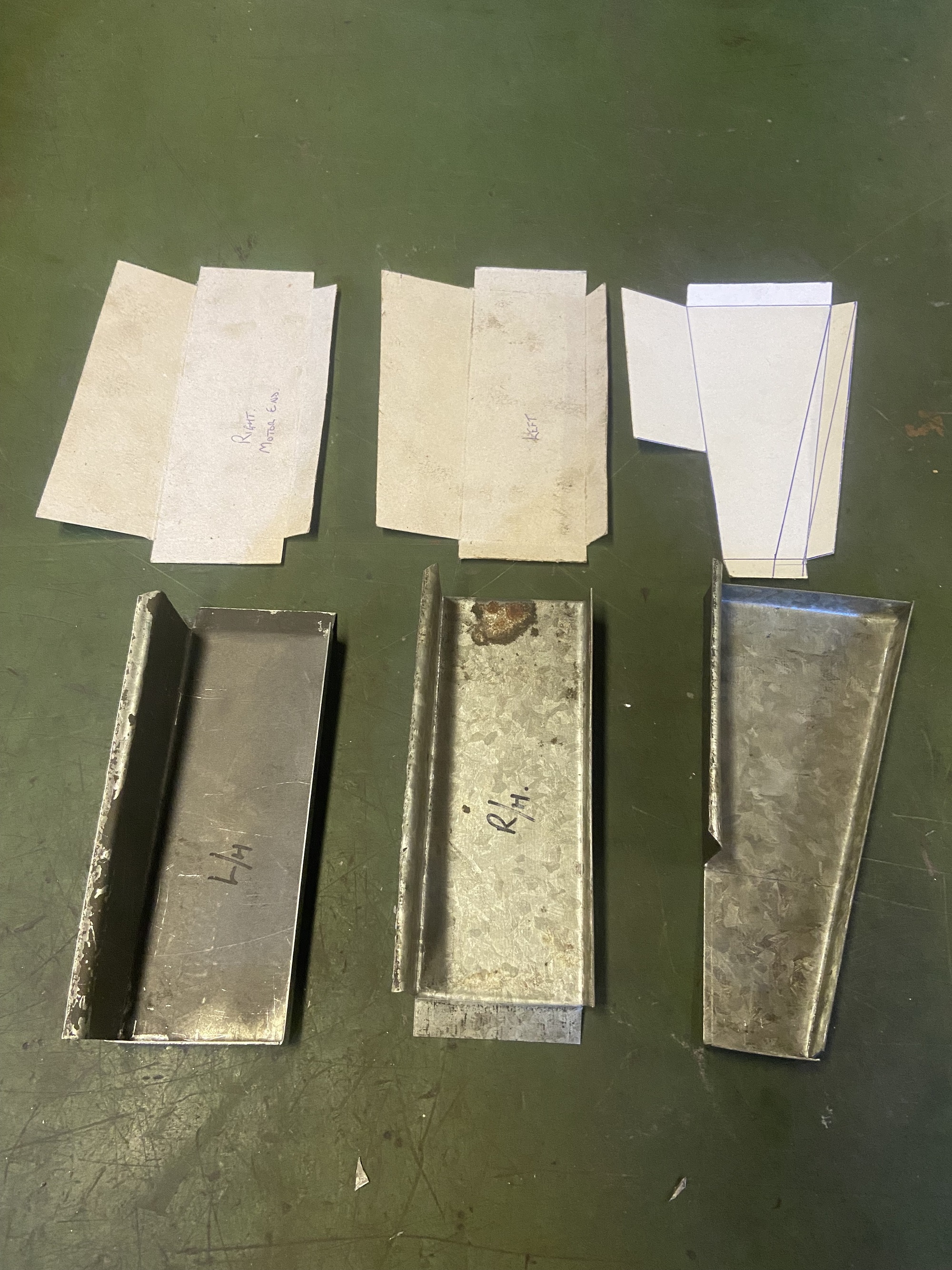

The drip trays are now fitted in place to catch any coolant that might be dragged around by the blade and leak over the floor.
Attachment 41496 Attachment 41497Attachment 41498
Two are manufactured form sheet steel and the one, being a purchase of a standard oven tray. (if there is such a thing:headscratch:)

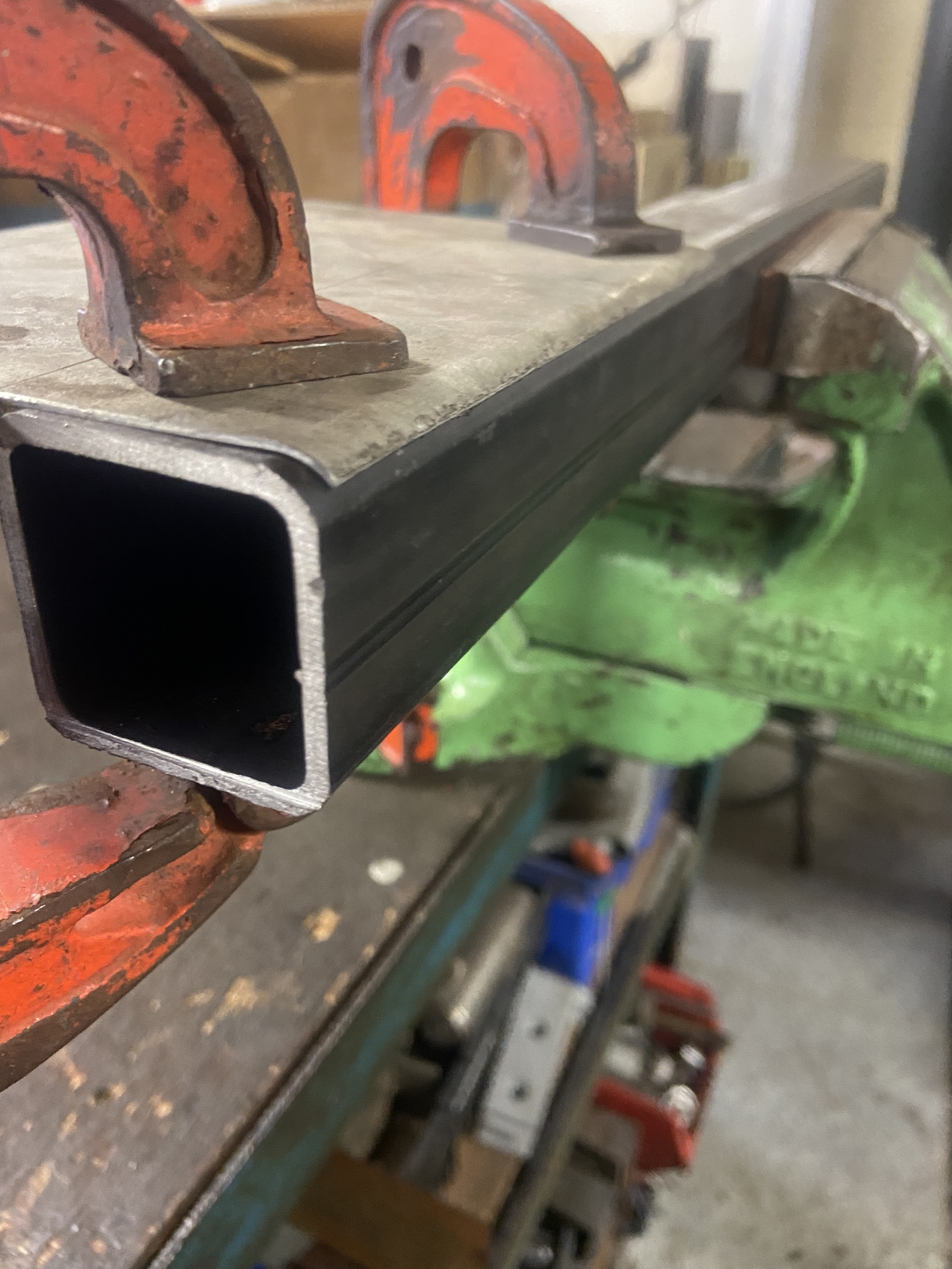

Templates were made from card and formed to check fit. Once Happy, this was then transferred to the flat sheet and cut out on the guillotine and corner-notcher ready for folding. Before folding I rolled the top edge to ensure the coolant doesn't leak behind the trays. The top edges are simply hammer formed to fit tightly to the base box section and in turn this then fitted under the casting of the saw. I didn't want to use a sealant but if this method doesn't work I may have to result to using silicon to create a seal.
Attachment 41499

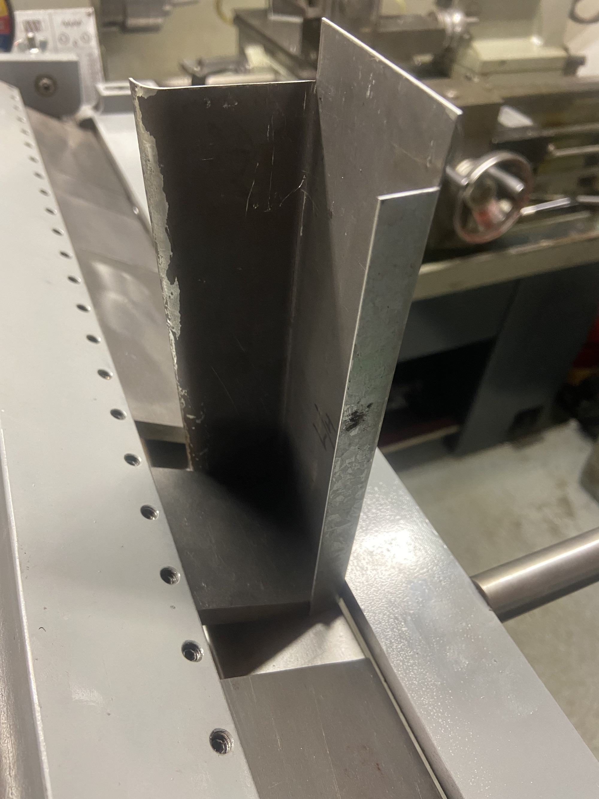

The trays were folded up on my home made box pan folder.
Attachment 41500
These then had the galvanised removed ready for welding. This didn't go to plan as my auto darkening welding helmet was to dark to see the weld at low amps. So was a little frustrating in trying to get a nice bead on thin steel. A new welding helmet as been purchased that hopefully will allow me to see.
The poor welding was corrected with the angle grinder and a flap wheel.

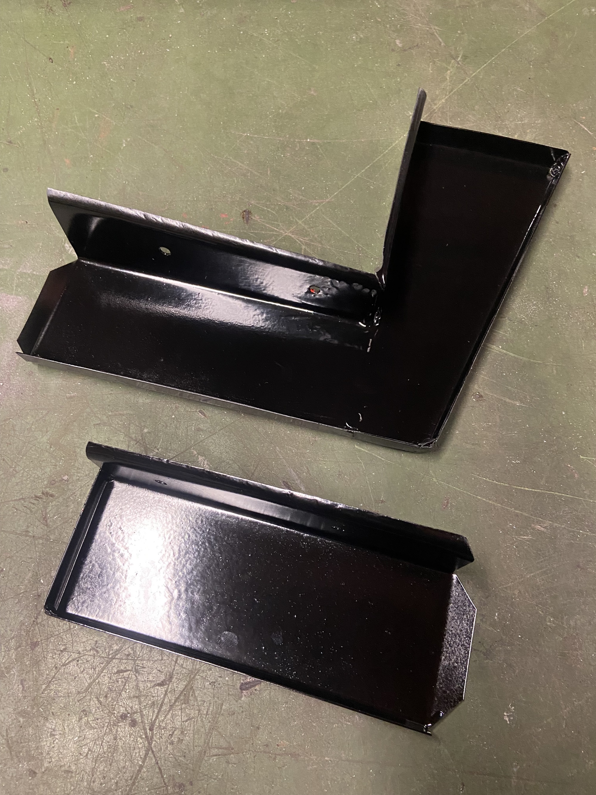

Attachment 41501Ready to be dressed for welding
Attachment 41502Finished and painted.
The custom base was drilled and M4 rivet nuts used to fix drip trays to the base.
The standard oven tray will need a drain hole and some sort of filter to protect the coolant pump from the swarf. This is also needs to be removable to clean the tray and filter. I also might need to shape the tray to aid draining so it doesn't pool and not return to the reservoir tank.
