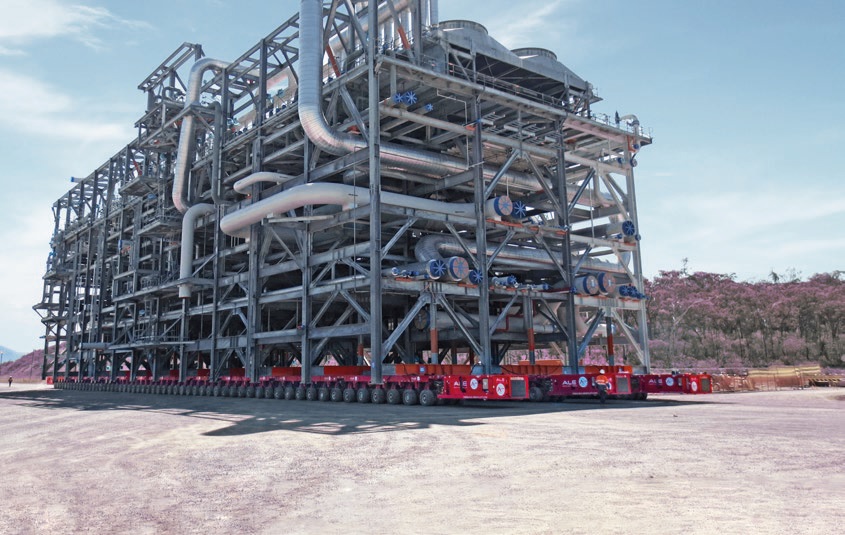

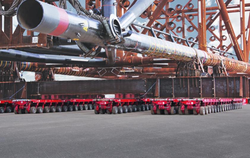

    These SPMT's (self propelled modular transports) have been around for a while the one used by the Collett transportation company hauling the 300 ton load is made by Scheuerle part of the Tii group There is almost no practical limit to the number of modules which can be connected together, the current world's record I believe is a 17,000 metric ton load on modules connected to make up 300 axles about 56.6 t per axle
    Here are a couple example pictures of the possibilities
