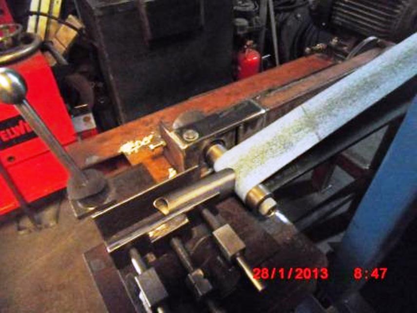

Not long before i was getting ready to leave kuwait I decided I wanted belt sander
for a project we were doing Inly I didn't want to build just any belt sander I wanted 1 that I could change the size of the idler roller and saddle pipes as well
The motor is a 3400 RPM 4500 watt

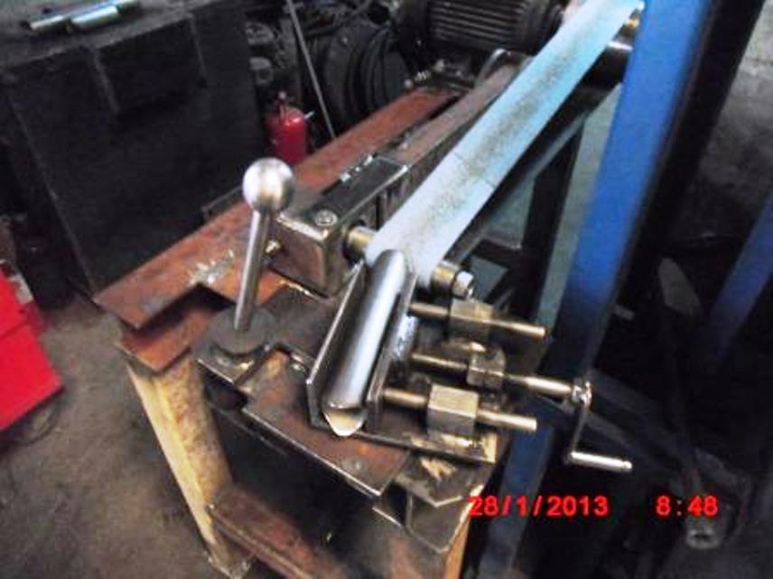

the gymble gear shift looking thing is for moving the pipe in or out or from side to side

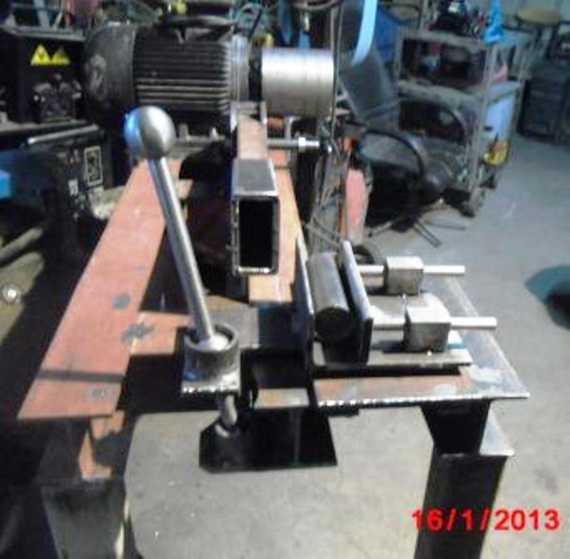

the vice can be set at an angle up to 45°

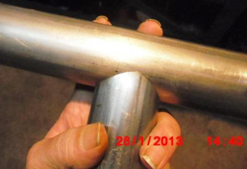

made perfect saddles
