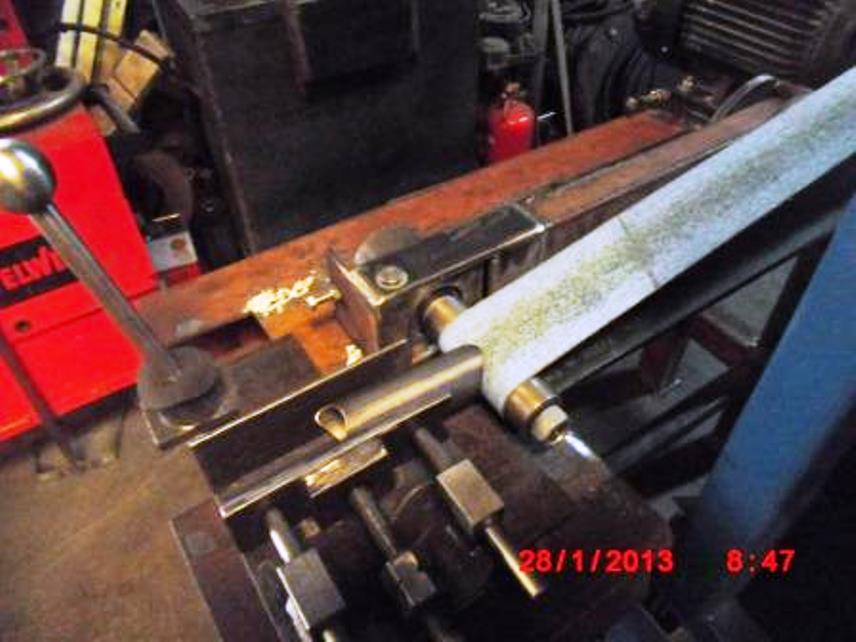

    Not long before i was getting ready to leave kuwait I decided I wanted belt sander

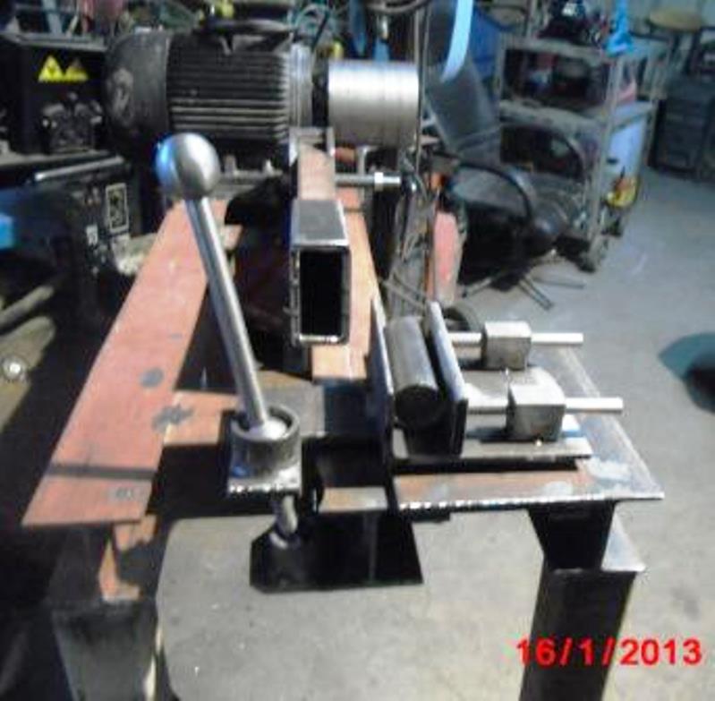

    for a project we were doing Inly I didn't want to build just any belt sander I wanted 1 that I could change the size of the idler roller and saddle pipes as well
    The motor is a 3400 RPM 4500 watt
    the gymble gear shift looking thing is for moving the pipe in or out or from side to side

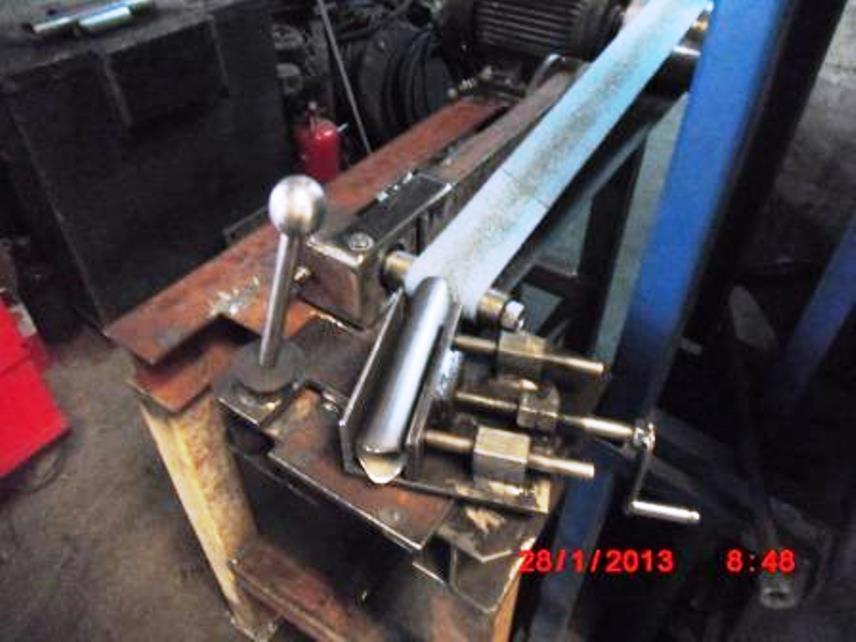

    the vice can be set at an angle up to 45°

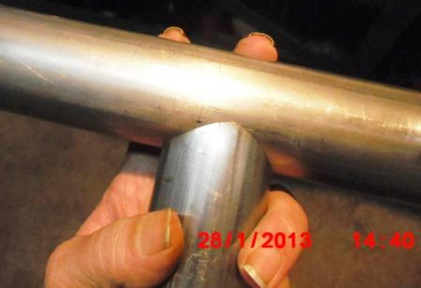

    made perfect saddles

    Yes it takes surprisingly little adjustment to change from a 1.5" OD roller to a 4" OD roller. TO make mine easy to change only the nut had to be removed from the idler roller slip 1 off slip the other on. At the motor end the motor was mounted on a 2 rail slide just like the movable vice jaw there was a compression spring on the screw a few turns to loosen or tighten the belt a few more to facilitate a roller diameter change.
    The single round ball gear shift looking thing moved the vice in and out and from side to side allowing for even belt wear
    and adjustable plate under the belt allowed for flat plane sanding or a fence could be added for sanding things perpendicular to the belt or at angles.
    As much as I dislike having to built something twice since my tools never made it back from over there this is 1 that I will be making again.

    One other thing in pic #1 if you expand it you can see a bolt head near the end that bolt is for height adjustment as well as the pivot for the roller tracking adjustment.. the roller can be set to center line of the pipe diameter or above and below the center line which is really handy when needing to offset grind the saddles for dissimilar pipe diameters.
    Say you want a 1.5" pipe to fit up to a 4" pipe but it must be co-planer with one side of the larger pipe set the roller to either high or low adjust the vice to square or a left or right angle and grind away the saddles will be perfect every time.
