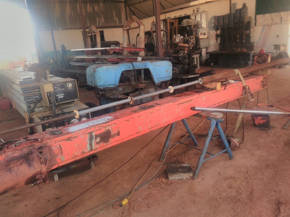

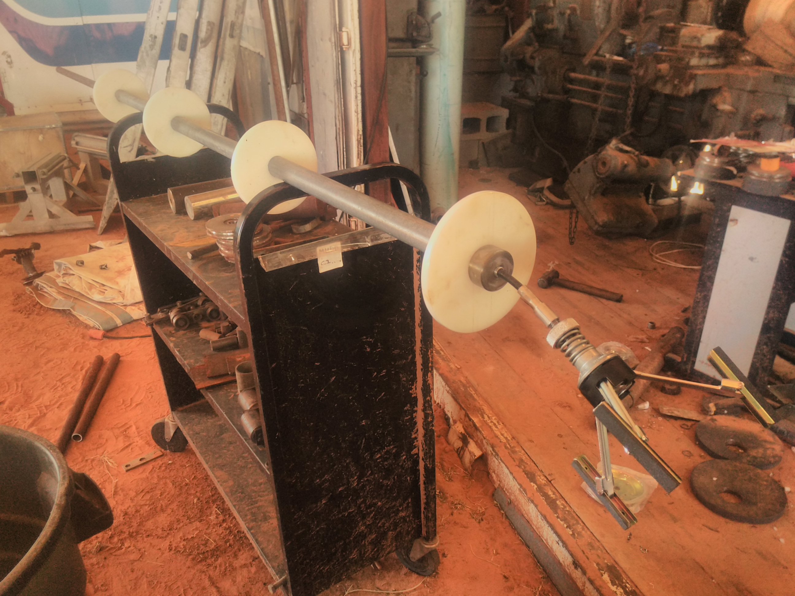

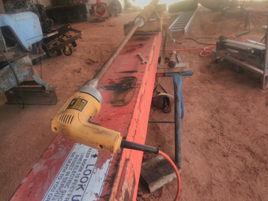

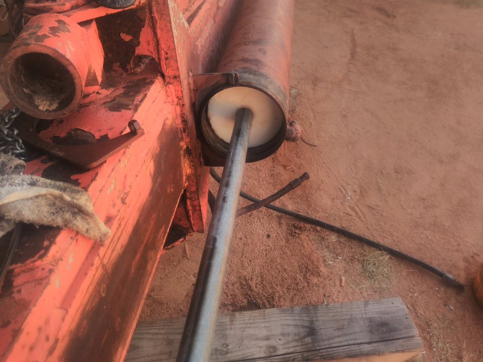

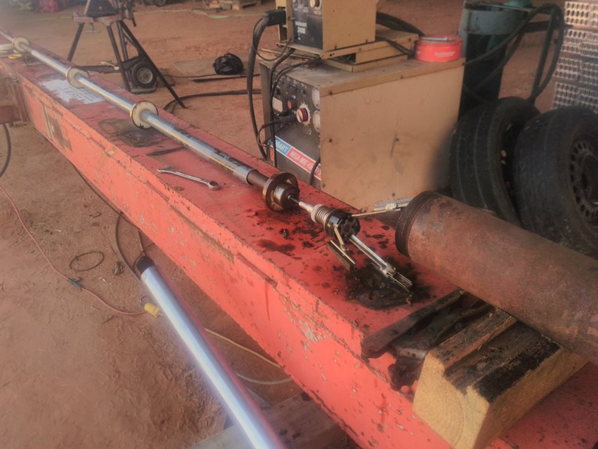

I no longer have a Sunnen hone set but needed to clean up the insides of a couple of cylinders 1 was a 3 inch the other a 6 inch. I have a 2Inch ball hone but wasn't about to spend the money to buy both a 3" and a 6" for a 1 time use But I have a new Lisle 2to 7" stone glaze breaker so I made an extension for that
