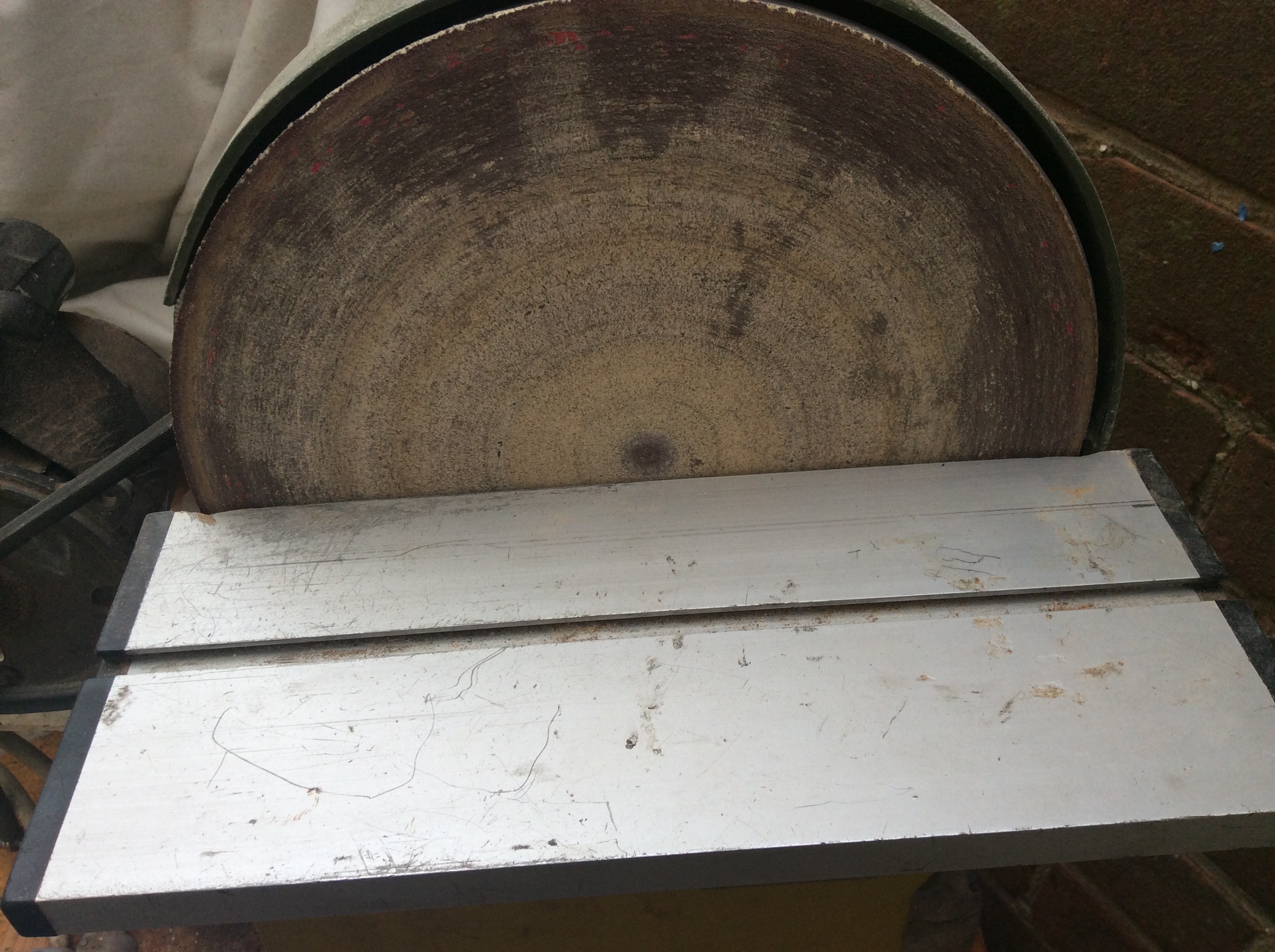

Attachment 42550
Attachment 42551

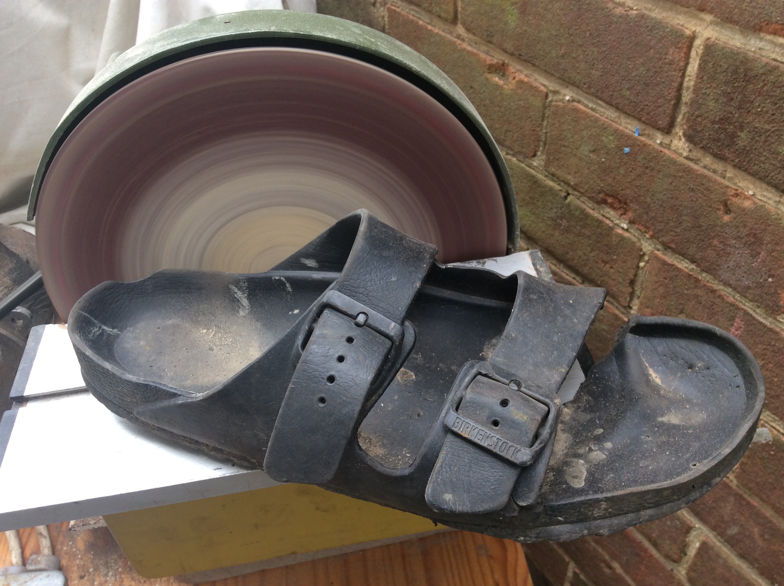

I think that an old shoe is just as effective as a proprietary sanding belt cleaner
Attachment 42550
Attachment 42551

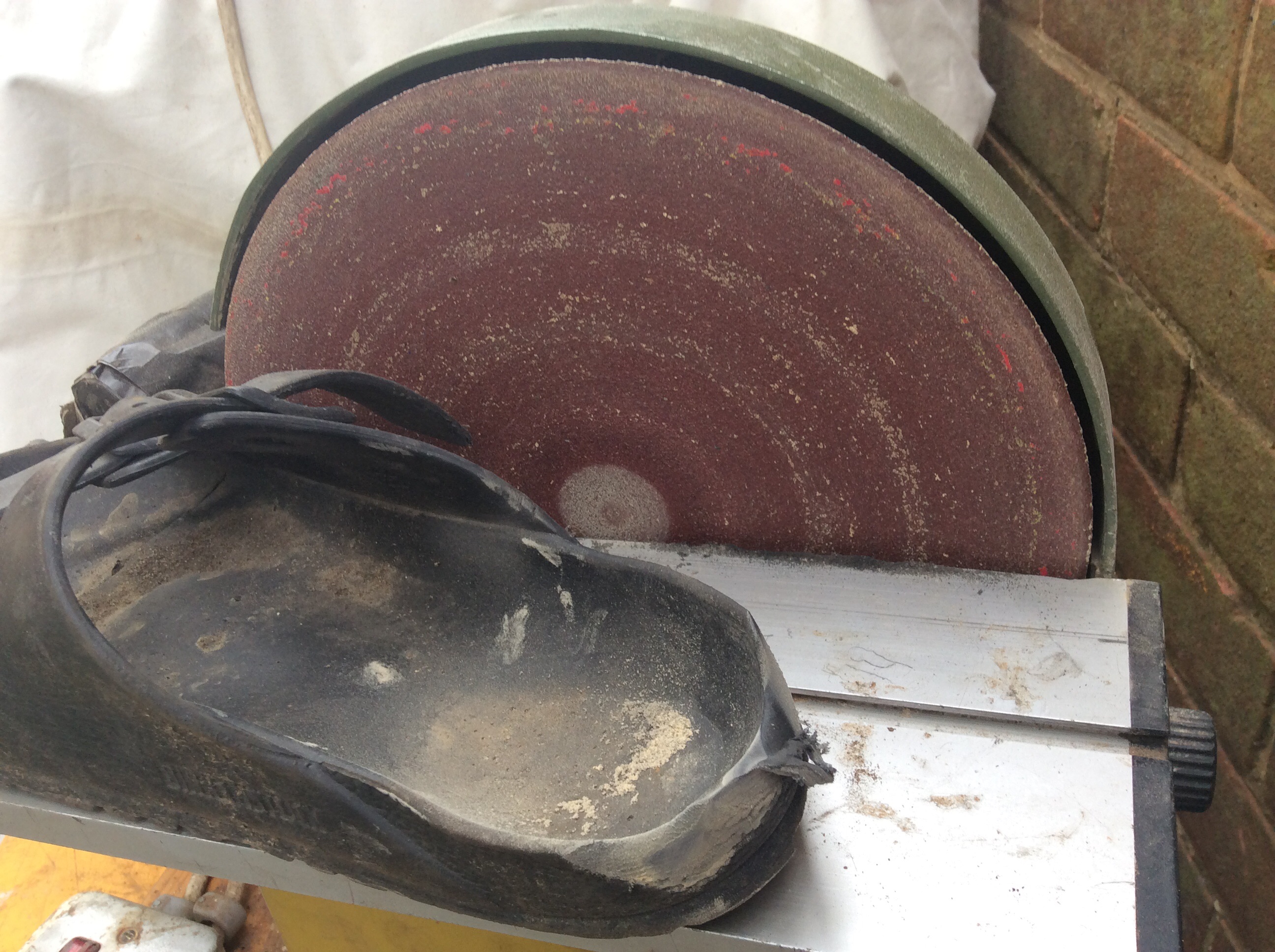

Attachment 42552
Supplementary picture showing cleaned disc and the amount of wear on the sandal.
I use an old tube of silicon that has gone off and that seems to clean disc and belt sanders pretty good.
