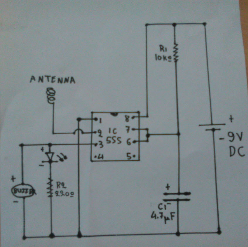

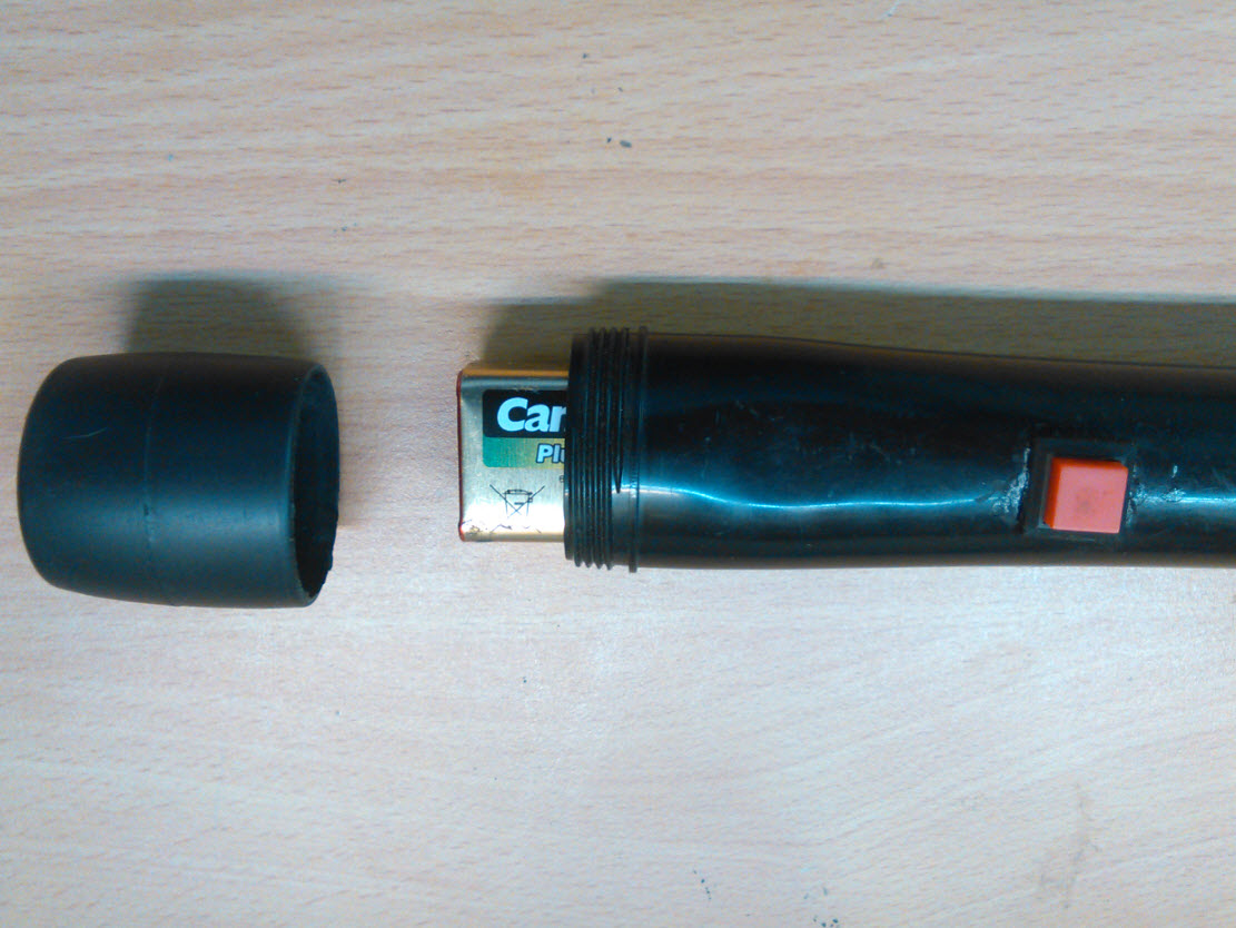

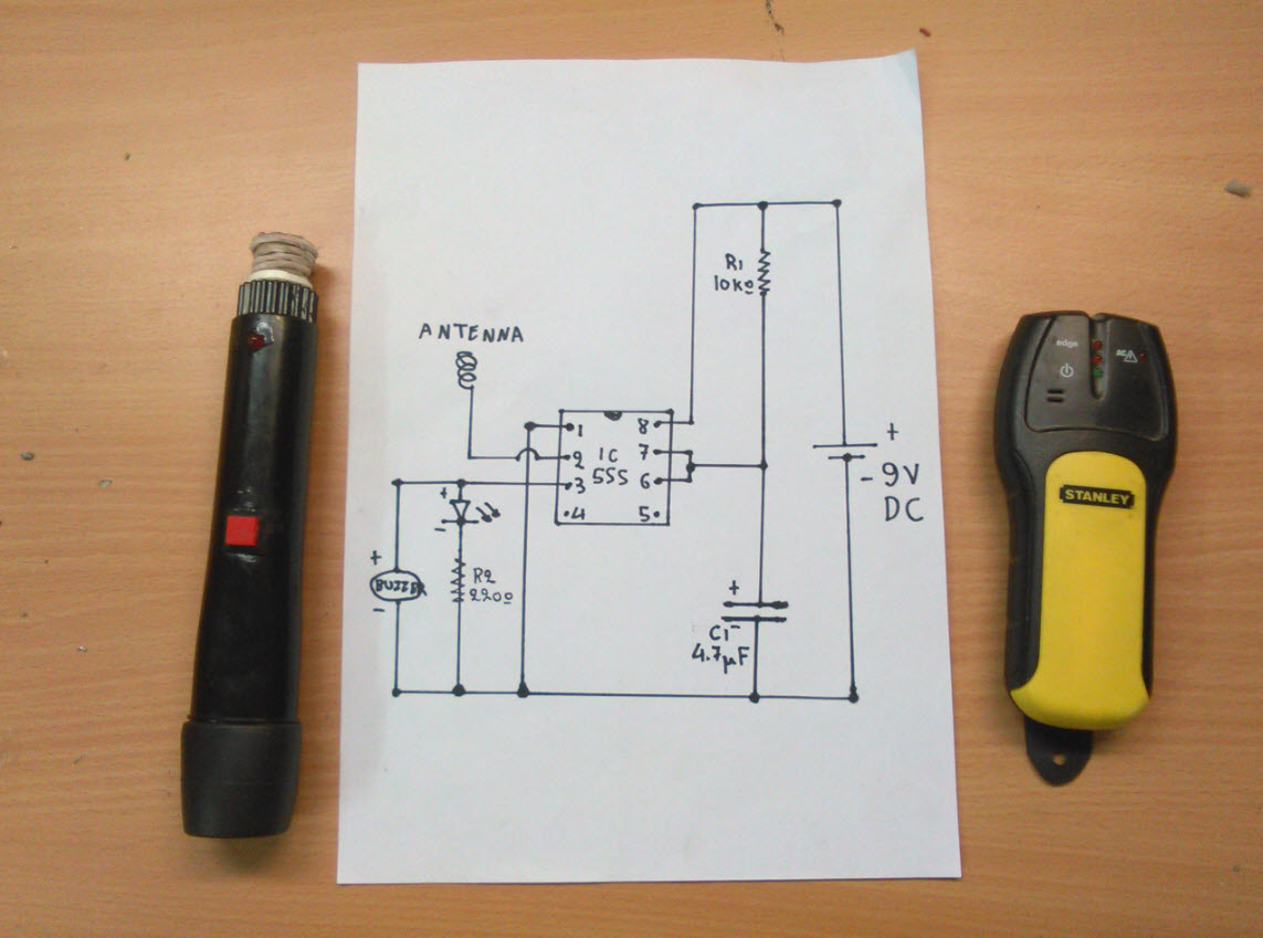

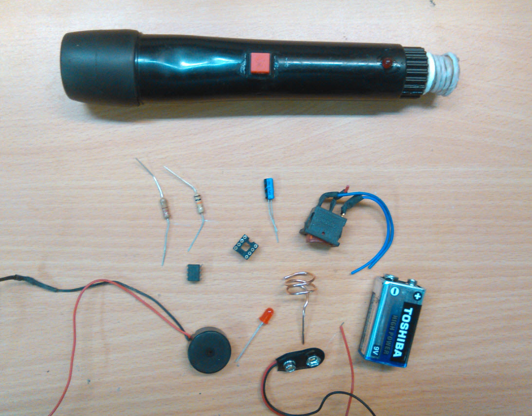

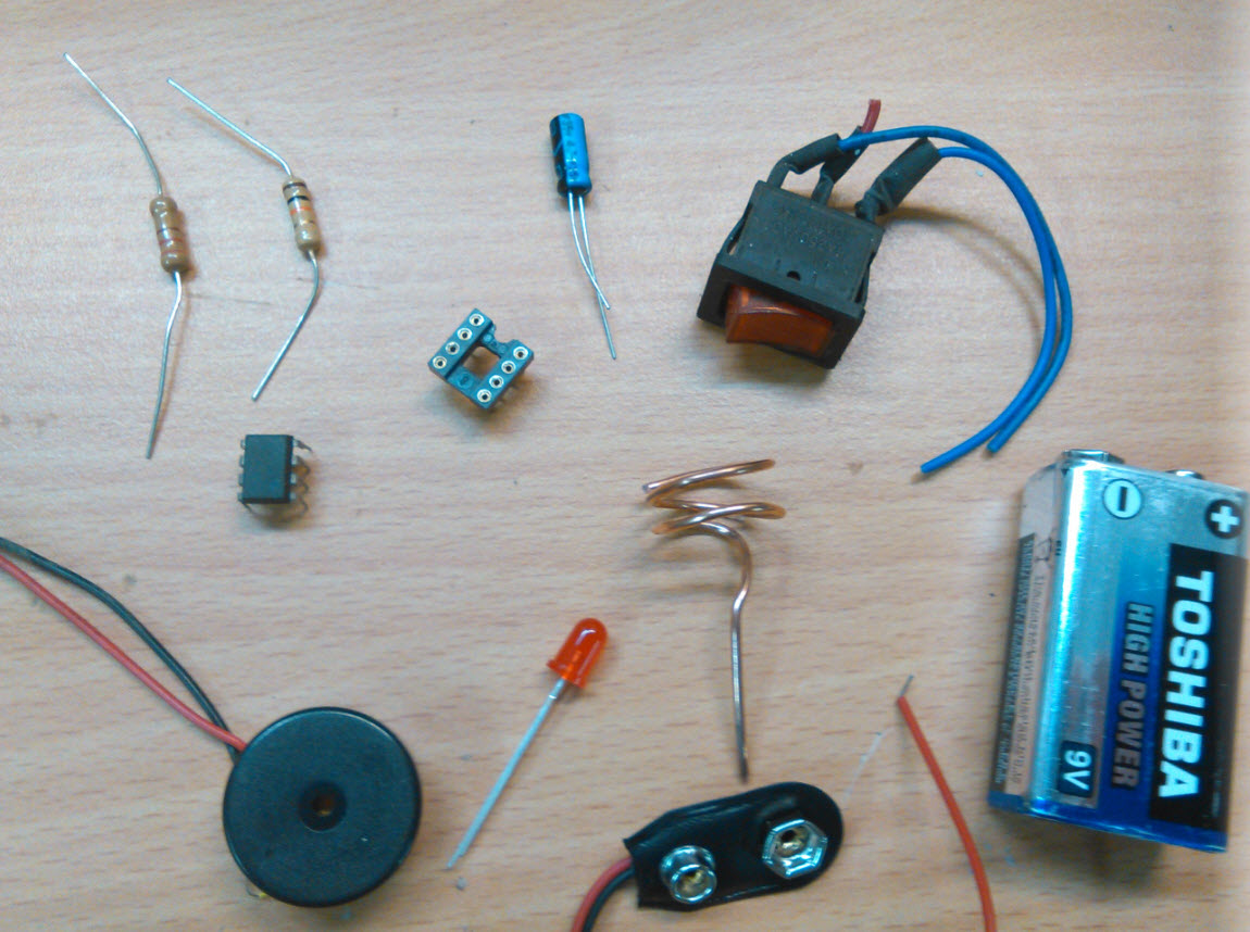

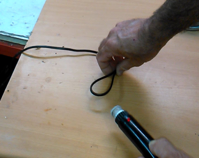

    AC DETECTOR DIY

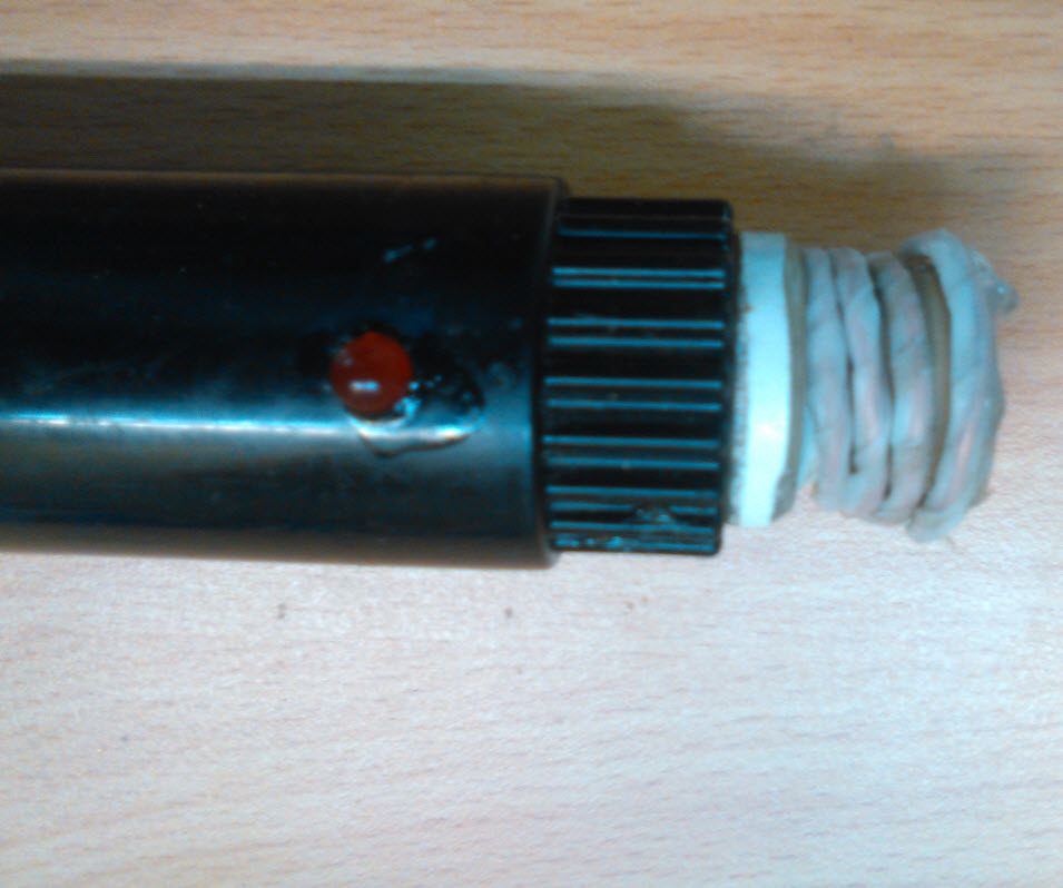

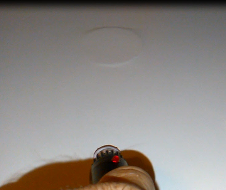

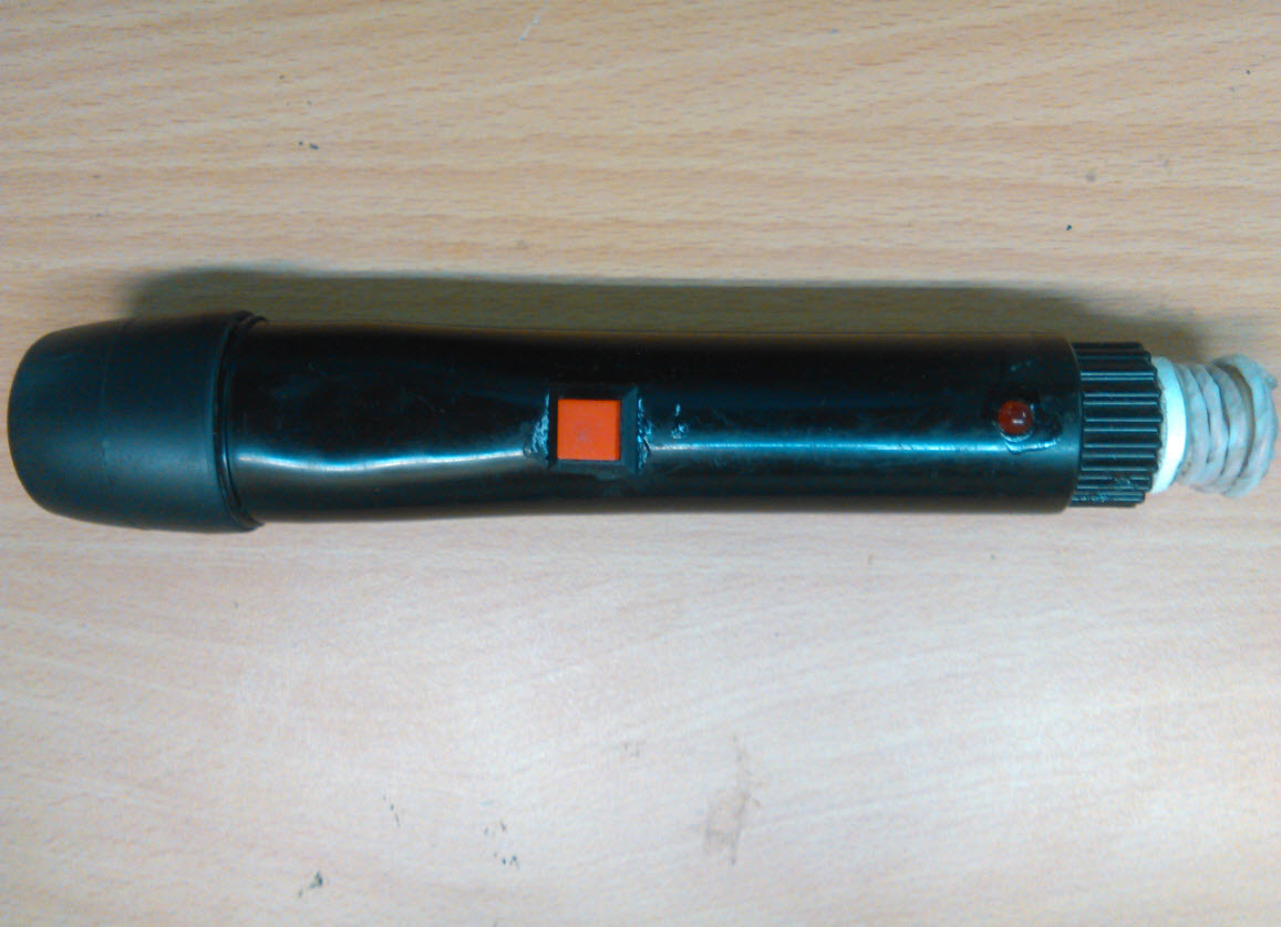

    An easy and cheap construction to detect ac current .We don't have to touch the line. It also works to detect the ac line in the wall if it isn't very deep. YOU CAN WATCH THE CONSTRUCTION AND THE USE HERE:
