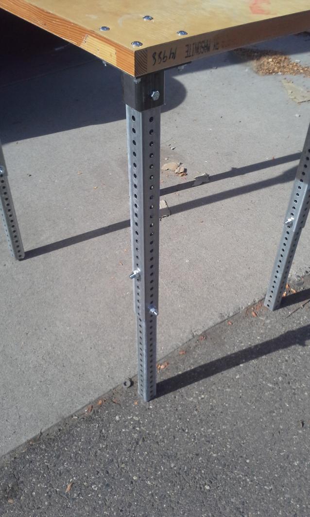

    I had an epiphany one day, and this was the result. Adjustable height table legs... Made (mostly) from perforated galvanized steel tube (there's another name for this stuff, but I honestly can't recall what it is at the moment...sorry). I purchased the tube from a local sign and barricade (road sign supplier) outlet.

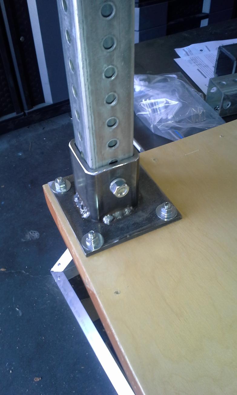

    The tubes are 2" x 2" with a telescoping section in the center that is 1 3/4" x 1 3/4" square tube. Both are available from the same source. I attached the telescoping legs to the table top with 1/4" x 5" x 5" steel plate welded to a 3" long section of 2" square tube (1/4" wall thickness). The rest is just a bunch of holes with bolts, nuts, washers, etc.. The sign post tubing is perforated with 7/16" dia holes every inch along it's length, giving 1 inch adjust-ability... The leg sections are 26" long, giving a range up to about 50" once fully extended. The table shown in the photos was set to approximately 44" from floor to top. This makes for a standing height desk or work bench for anyone 6 ft tall. But as I said, the table can be adjusted up or down as needed. Once assembled, it was found to be quite robust and stable.

    Thanks DIYer. I'm not certain what analog to the steel tubes exist in aluminum, but if such a thing does, it would make for a much lighter weight setup. Laptops weigh next to nothing, so aluminum legs would have more than plenty of strength. It would also be a bit easier to machine...

    Cost likely depends greatly on prices from local sources (i.e., in your area) for the materials. I didn't total things up for these, as it was a company expense, and a one time 'sunk cost' purchase.
    In our case, we have staff using them to hold up desks, and the traditional sort of legs were 4" x 4" timbers. Because we must follow ergonomic rules for proper working height, each desk potentially ends up a different height.
    Some staff also want/need to work from a standing position, others sitting down. Since we have limited storage space, we can't stack up numerous wooden legs for each height table. That means we're looking at purchasing new timbers (at approx $30 per table), then cutting to size, etc... Any waste or excess wood had to be tossed (no storage, remember?) which is very wasteful. Changing to different length legs, is also an issue as well; as it means removing a bunch of screws, sheet metal brackets, etc...(very time consuming!).
    So while the bolts and nuts, washers, aren't the most convenient; given our old way of doing things, they aren't the least either. I also think they help make the legs more rigid, which helps with stability.

    . Great idea, If you want to make it easier to adjust, Google "pip" pin, or "sword" pin. One has spring loaded balls, like the retaining balls on a socket set ratchet or extension bar, when inserted into the hole the balls prevent the pin from coming out, you pull the ring on the end to release. The sword type has a blade pivoting at one end which turns 90 degrees after insertion and needs straightening to remove. Or you could just cross drill some round bar that fits and use "R" clips to secure,(much cheaper).
    Hope this may be of use.
